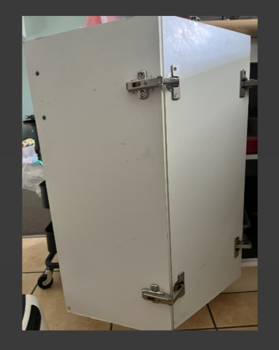

current situation in my kitchen corner cabinet at the moment.,
The hinges being used are as follows
I have been bunning few times, and brought few, and did not look like I got the right one.
Can someone point me in right direction please.

Hi @Sugar,
The hinges that connect the two doors are called bi-fold hinges. These Hafele Salice 70° Bifold Corner Hinges should do the trick.
If you wanted to replace the hinges that attach the door to the cabinet itself, you would be looking at a full overlay hinge that opens past 90°. It looks like they open a fair bit past 90°, so I think you'd be looking at something like these Hafele Salice 165° Full Overlay Hinges.

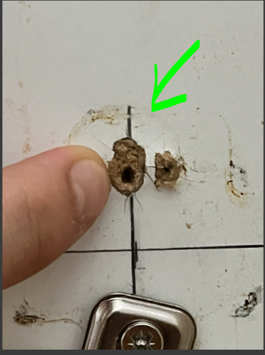

Until I found that the holes have already become too big for screws and little not firm. When I put the screws they come lose after few open - close.
I tried to using the cuts of disposable earplug ( i knew it was not the perfect solution.),.....andddd it did not work.
I saw that others are using some rubber tubes inside the holes, what are they ???
I think once I fix this , the problem should be fixed.

Hi @Sugar,
What is the rough diameter of the holes?
You could use a Ramset Wall Plug of the corresponding diameter to the hole, then screw into the plug. If the current diameter doesn't match up closely, just drill the hole out with a drill bit in the corresponding diameter to your wall plug.
Tap the wall plug in place, then cut the excess length off before screwing the hinge back in place.

@JacobZ This maes perfectly sense. I will do this. Thanks for advice.
