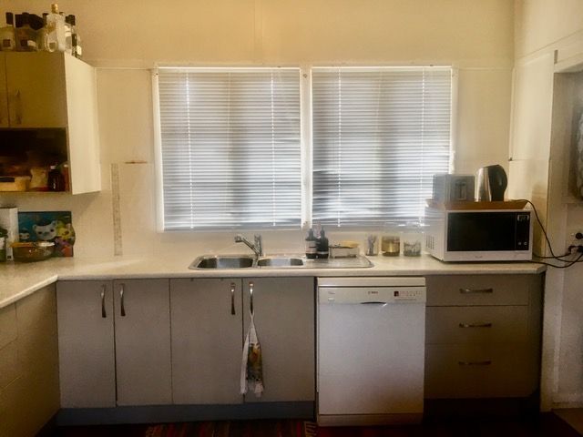

For my kitchen update, I have made some choices on materials and colours but I am visually challenged I think!  I am finding it hard to imagine it in my head:
  • Bottom cupboards (Mocha latte) will stay
  • Range hood will stay
  • Vistelle backsplash over both benches in the L shape (Salt) - no more tiles!
  • Benchtop all the way around - Think benchtop solid 38mm (Meringue) - I would prefer the 20mm thick so if you think one of the same range would look ok I would love to see it as well as the 38mm
  • Kaboodle (Vanilla essence in gloss) top cupboards from rangehood around the corner to the window - old microwave cupboard will go
  • Still deciding on whether I have knobs or no handles on the top cupboards
Looking forward to hearing your thoughts!  Looking for a modern update and more storage..  I have an all white walk in pantry to the right of the microwave and another pantry like cupboard in the Mocha colour behind where was standing to take the photos.

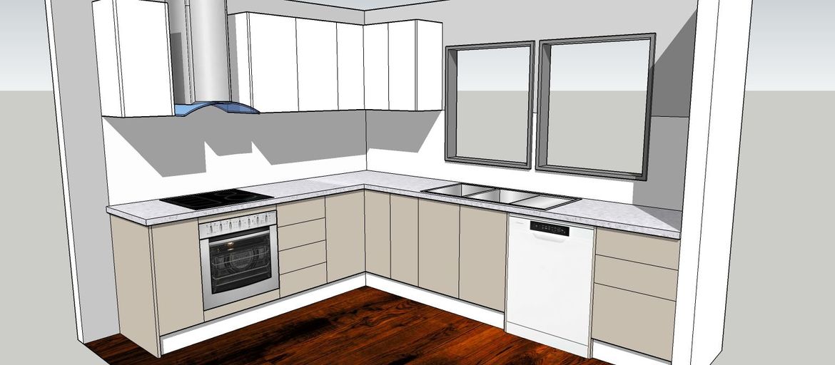

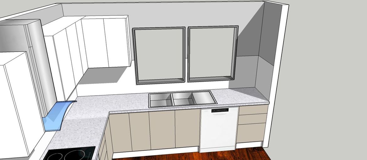

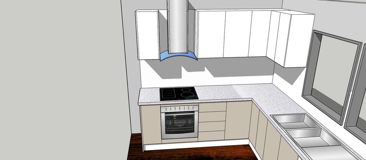

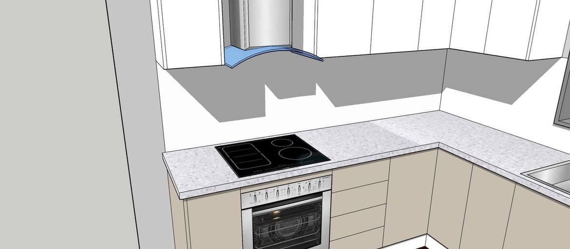

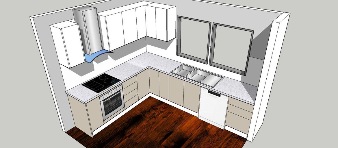

As requested here is the visualization you were requesting for!
- I continued the cabinets in mocha latte to match your cook top side.
- To balance the look of your kitchen, I suggest your rangehood to be lowered so that is in line with the bottom part of your new wall cabinets. This is still allowed as you have an electric cook top and the required distance is 600mm from your cook top to the bottom of your range hood. Please check with your local council for rules and regulations in your area.
- I've colored your wall a light gray to create contrast for your new splash back ( salt ) in the Vistelle range
- I've drawn the top at 38mm this gives it more of a solid feel and is in keeping with the look of your current kitchen.
- Vanilla essence is a light color and is difficult to replicate on the computer screen so I've placed the color as close as possible.
- Handles are at your discretion, why not bring one of each home and test it on your current doors and see which one you like?
I hope you enjoy the drawings and that it gives you inspiration to explore the possibilities. If you have any more questions drop us a note here on workshop.

Thank you for these pics! It has certainly helped with visualising the updates.  I think I might need to rethink the benchtop colour back to a less busy option ie white with a small sparkle.  I'm not sure that the stone like options come in the colour I'm thinking.  Do any of the thermos benchtops come in a high gloss to look more stone like?  I am also thinking I should change the upper cupboards to finish at the wall with the window rather than go around the corner.  I am worried they will dominate the space as I don't have the open style kitchen with an island where the upper cupboards tend to look good.  I'm also a bit concerned about the two tone cupboards so might look to replace the bottom cupboard doors to match?  I am definitely out of my comfort zone on this - cant imagine what I would be like with a full house reno!  Great point about the handles!

Your kitchen reno is going to look amazing. I would keep the darker colour for the bottom cupboards. It provides a great contrast and visual interest to have the colour contrast between the top and bottom cupboards.
if you’re concerned about the top cupboards overwhelming the space, you could keep them across the one wall. On the window wall, you could put some open shelves on each side of the windows to balance the look. That would give you some extra storage while not closing in the space.
I agree, a lighter benchtop would look better, with sparkles or even a pale grey vein marbling through it.
Regarding the rangehood, it looks much better and will be more effective being down lower. Keep in mind those corners in relation to eyes and heads bumping, when deciding on final placement.
