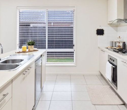

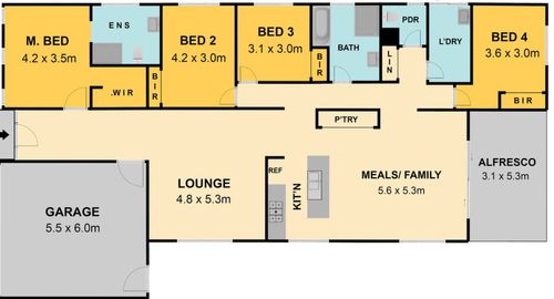

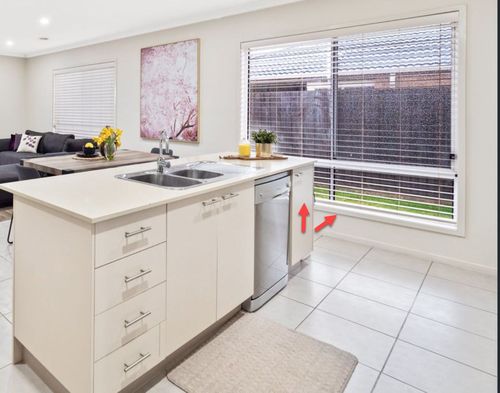

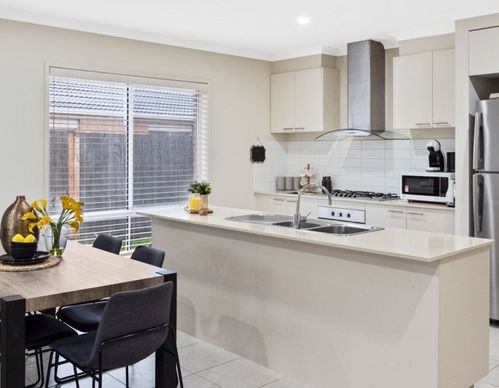

We are planning to upgrade our kitchen. Can someone please provide your valuable thoughts?
With the existing kitchen, we don't have enough space to keep our appliances. we need more space for our appliances.
I have below plans.
1. Remove the last door and extend a bit to make space for micro oven. Replace the benchtop if required.
2. Extend the existing bench top to the wall, add a new small benchtop to the wall(making an interverted U design). Change the window to smaller size.
I believe creating a hidden pantry would cost more. Please provide some insights.
Any other ideas or suggestions will be much appreciated. If possible please provide approximate costsRemoving last door as shown
Side view
Main view
Layout

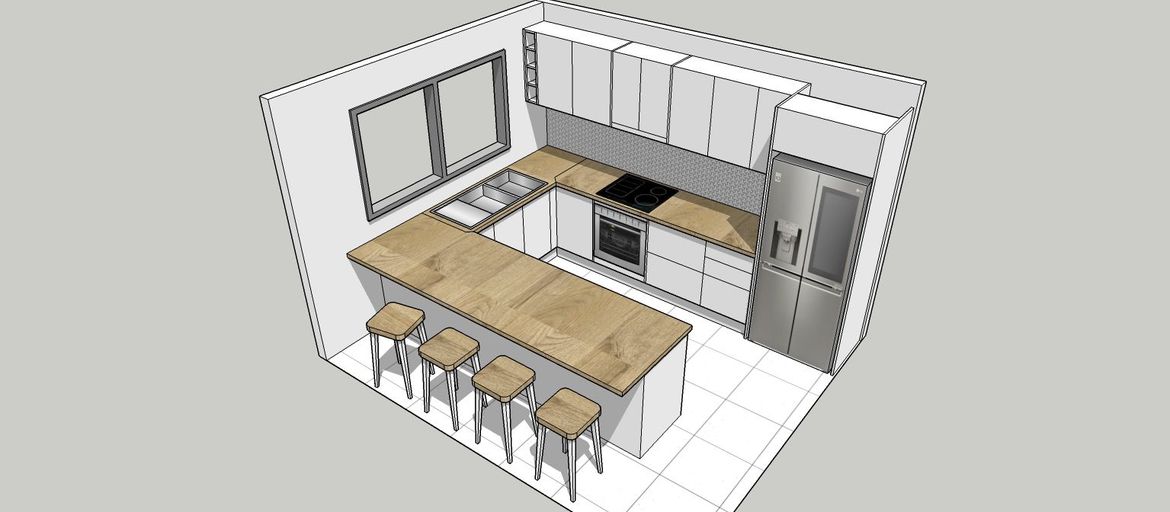

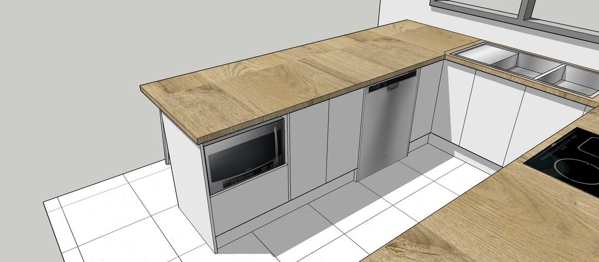

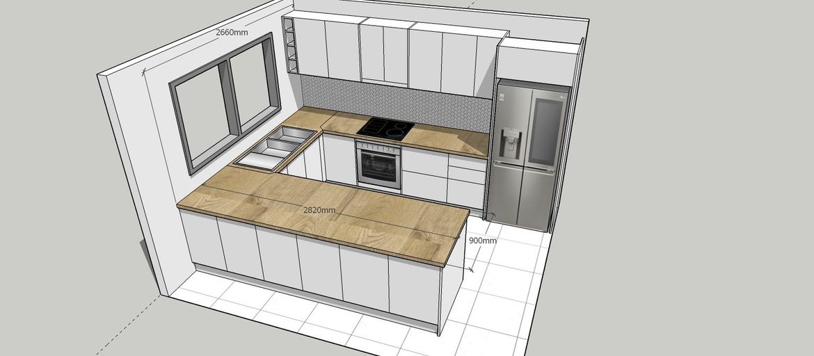

While we're waiting for your measurements I've taken a guess as to the current size of your kitchen and what we can put in there. I've even done a version of one that @Marlene1 suggested. Have a look and tell us what you think!
Cheers,
Red
Standard extension in "U" shape, but move to the sink to the window to open up the breakfast bar area.

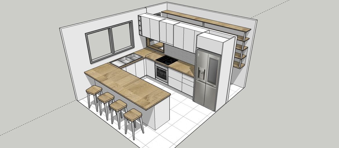

This version with cabinets placed in front of the breakfast bar for full space use.

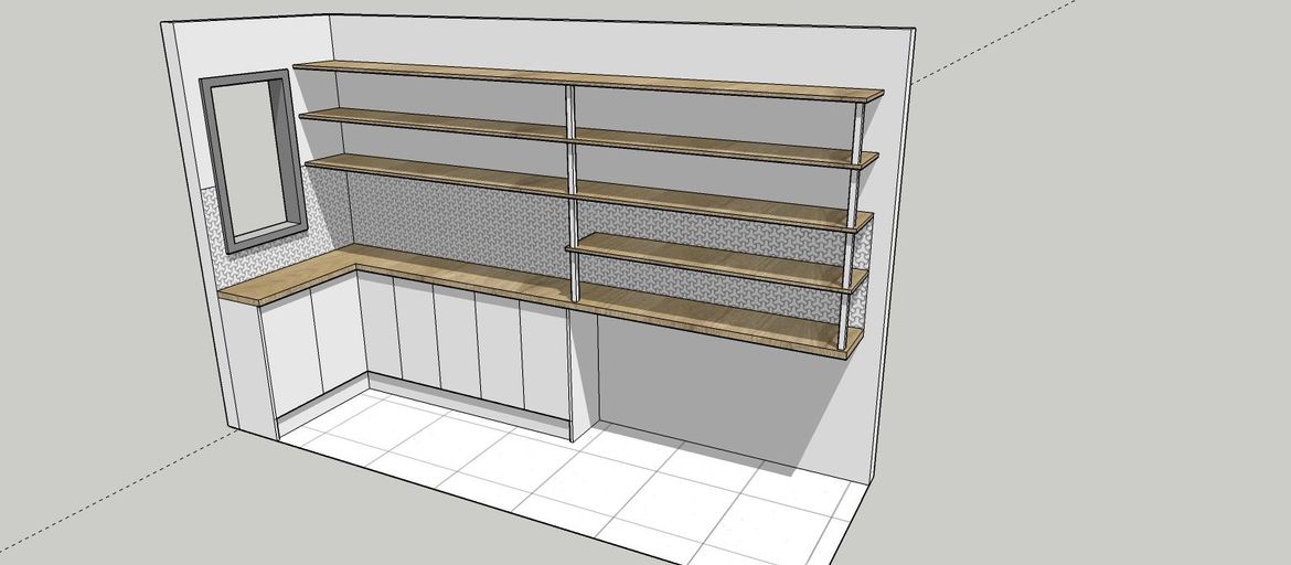

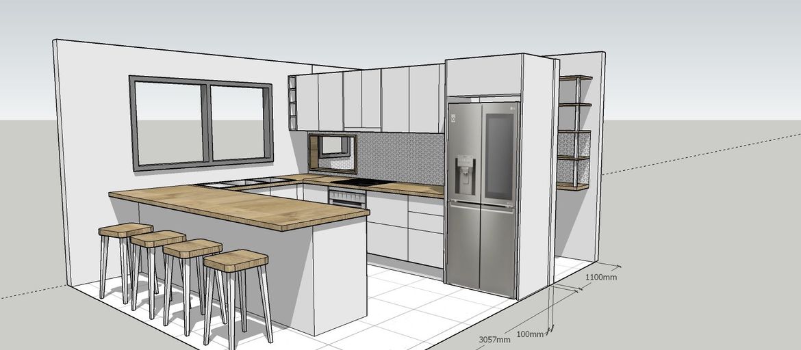

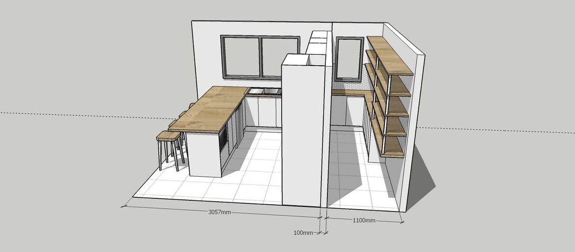

Move the entire kitchen 1100 mm forward to create a walk in pantry at the back of your kitchen and a servery window through the dividing wall.
Check out that servery window!
Suggested pantry layout,but final layout is at your discretion.

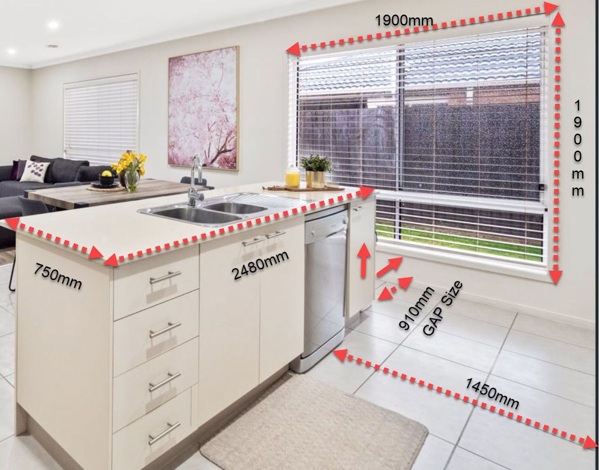

Hi @redracer01 ,
Thank you for your contribution. This is exactly I was looking for.
I have attached the picture with dimensions.
Measurements
Sorry for the late response.
Could you please also provide ideas on extending without changing location of the wash basin. I am planning to avoid plumbing to keep cost minimal. How about extending with similar 20mm stone benchtop and painting all the benchtop to match?
