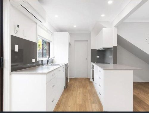

Another option is move the stove top to where the fridge is, open up that wall similar to last plan but more of a pennisula and then put fridge over by sliding doors on other side. I'll do a rough plan. It would be a little like this place

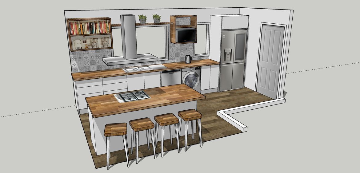

It's great that you've received so many fantastic suggestions for your kitchen renovation from our members. The reason your kitchen roof is so low is that it's hiding the plumbing and electrical services for your second floor. In theory, you can use the space in front of your laundry door, it would just need to be permanently closed but not modified from the outside. The same goes for your laundry window, this will allow you to use the space without changing the appearance of the unit from the outside.
I'm afraid the laundry tub will need to be sacrificed for more benchtop space. I've drawn up a few possible configurations, but I suggest following my colleague's recommendation on checking with your local council on the rules and regulations of a WC door opening directly into your kitchen.

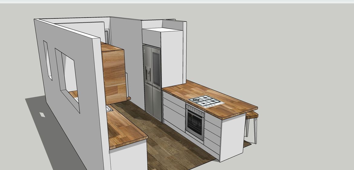

What are your thoughts? Could I see a sketch up with the fridge still in place and it as a pennisula? Thanks muchly. So amazing.
Clare

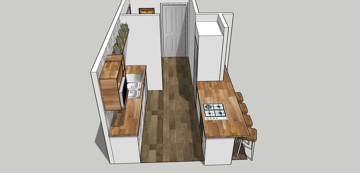

Hi @renonewbie (Clare)
Allow me to re-draw that kitchen up for you, I'll post the updated version as soon as it's done.
Hello @renonewbie
Thank you for your patience, below is the updated render of your kitchen. I've placed the refrigerator back into its original spot and have removed the wall to give you that open breakfast area that you were after. If you wish to see the kitchen in another configuration, please let me know.
