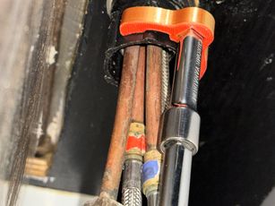

Re: What plumbing tool to use to remove mixer tap fixing nut?
Hi!
I found this post while looking for a tool to work with a very similar, if not the same back nut. The Irwin basin wrench is not wide enough to catch this nut, so I designed and 3D printed one that does. As the nut is so far recessed, I couldn't measure it other than eyeballing it from a photo. I almost got it right, the first version didn't catch due to flexing. I have yet to try the second version, which can be closed off. If anyone still needs this tool, I will post it online once I test it.
Hello @Murat
Welcome to the Bunnings Workshop community. It's sensational to have you join us.
Thank you so much for sharing your knowledge and experience in regards to removing the plastic fixing nut of the kitchen mixer. That is indeed a very clever way of using a 3D printed wrench to remove such a deep-seated nut. I don't think I've ever seen one that does the job properly. Once you have it perfected, please make sure to post a photo of the tool. I'm sure our members who are in the same situation will find the information very useful.
