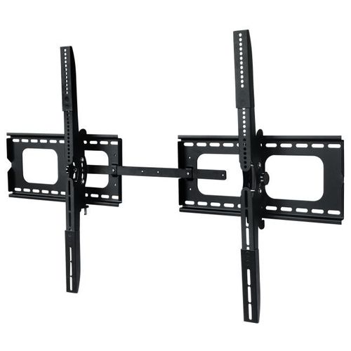

My question is, what is the best approach to installing a 98" tv (54.3kg) into a wall bracket on a steel studs.  VESA hole pattern is 800x600.
I have a MJH steel framed house and am now looking to install my tv via wall bracket.  I have installed this setup in the past with a 60kg plasma tv but it was into wood studs via coach screws.  Can you please advise best screws or setup to use in this scenario.

As you can see it is now analysis paralysis.  I will include photos of the wall and bracket shortly.  Please let me know if you require any other info.

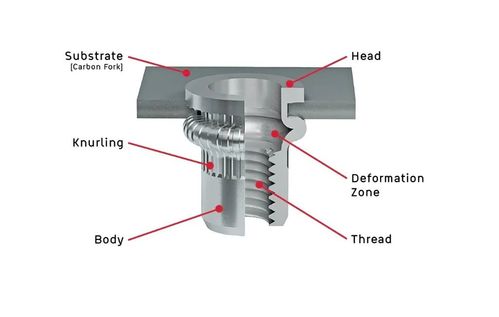

Way back in sixties and when I came out of RMIT in 1971 and worked in industry we called them Root Nuts... and they still exist.
The popular choice today is a Rivet Nut.
Both are basically blind nuts.
Work out the location of the VESA bracket and add more framing to install the rivet nuts.
Buy a small pack of screws same thread and leave leave 4 screwed in there for the plastering.
Come back to discuss some more...

@AlanM52 suggestion of using Rivet Nuts is ideal, it has excellent weight carrying capacity, but it is dependent on the material that it is anchored onto.

I agree with @AlanM52 in that none of your suggested fasteners will be suitable. And though Rivet-Nuts are an excellent idea, may not be that easy to install if not familiar and require a special tool to install them. But they are not that expensive. I bought one as an attachment for my drill. You would need at least M6 size and a min of 4 fastening points. But as you go up in rivet size, they are only suitable to grip a larger thickness material. This is where it will get problematic.
