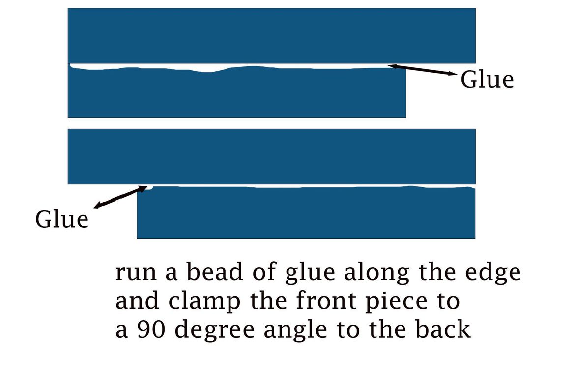

Glue one side to one of the back and clamp. I nailed it as well.
They need to be mirror images. One will have the opening for the mirror glued to a long side on the right.
The diagram below shows the way the 2 sides are glued to the front.
Step 5
Glue the two pieces of front/back together and nail. Clamp and leave to dry. Wipe away excess glue.

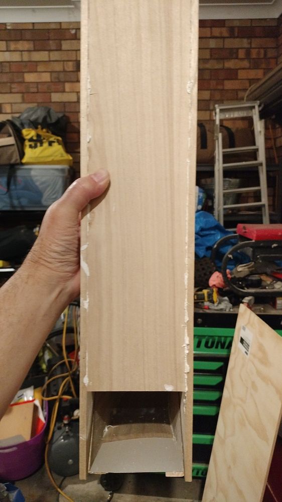

Cut mirrors to size and glue to the triangular supports. Mirrors are 100 mm x 120 mm.
I found the acrylic mirrors wouldn't stay flat so I ended up purchasing a large mirror and glass cutter. I then cut 2 mirrors to size from the large mirror.
Glue the glass mirrors to the inside of the periscope body.
Step 7
Measure and cut a piece for the top and the base of the periscope. Glue and fit. Wipe away excess glue.

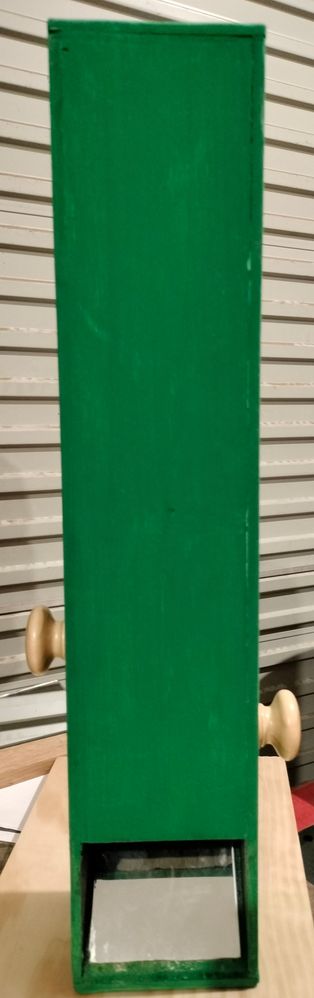

Paint the outside of the periscope. I used green as I wanted it to have a dinosaur on the outside. I painted 3 layers and allowed to drive in between coats.
Step 9
One again, I discovered something which would have made it easier at the time. I should have attached handles to the sides before gluing the front and backs together. Insert facepalm here.
To fit the knobs, I measured the middle of a side, measured up from the base and drilled a hole for the knob. Repeated for the other side.
I slid my hand inside the periscope and fitted the bolt through the inside and screwed the knob on the outside. Repeated for the other side.
Step 10
I cut out a dinosaur design out and drew onto the two sides in heavy texta. I'll repeat over the lines to make them stand out more. The almost finished product is pictured below.
