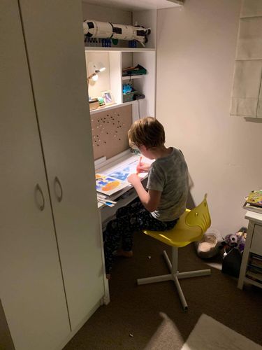

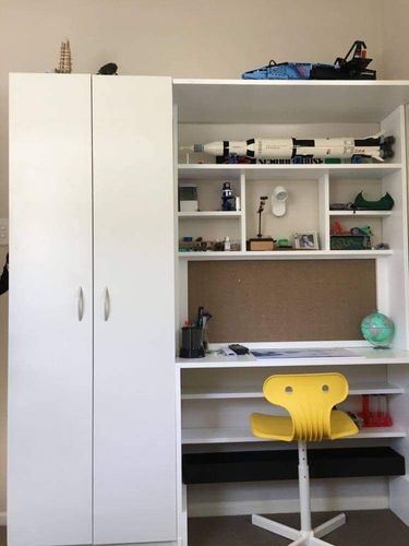

Using quarter sheets of mdf from Bunnings (18mm) easy to fit in the car cut these to make the desk fit 1000 long 400 deep to match the flat pack Bunnings sell and 730 work height. Screwed two shelves under neat and made a box (black) for under the desk. The shelves I cut to give home some shelving and made the top 400 deep and the shelves only 200 so mum has some room for stuff for him. The existing light was taken into account. Glue sand screwed and filled with builders bog, sanded back and a sealer coat of BP 4in1 and two coats aquanamel satin white.
all installed for 8.9.20 🛠🍷❤️
InstalledInstalledIn useIn use
