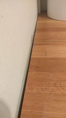

The AEG 1200W 184mm Circular Saw would be a great tool for the job. Personally, I feel the sharp 24 tooth blade it comes with would be fine, but you might like to do a test cut to check the finish. I completed my most recent projects cutting these panels with a blunt and rusty 24 tooth blade and it gave a fine finish.
I've included below an image of the type of cut I achieved with the old blade. The cut is perfectly straight, and it is the old fibro wall which is distorted. As you can see, there is no tear-out, and it is a near-perfect cut.
