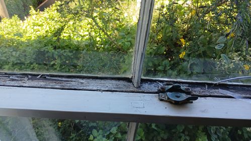

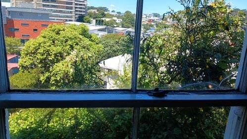

Hi! My sash window has quite a bad draught coming in through the gap between the top and bottom window.
Both to keep bugs out at night and to keep out the draught. Its the only window in the room, so I'd rather keep the ability to open it.
I've considered foam stripping, but I'm concerned that opening the window would tear it away, and I'm not sure how I'd apply it.
Alternatively, I've considered applying a door seal to the window, that can be pushed out of the way when it slides up.
I've not done much home improvement before but I've just moved into what will hopefully be my home for the next few years at least, so I want to make it as nice to live in as I can. Thanks!

I was going to actually suggest using a Moroday MDS2B Self-Adhesive Black Econo Door-Seal on the section of your window that moves. This will prevent it from getting pulled off and stripped off. I propose drilling small pilot holes on the door seal body so that you can screw the seal onto your timber window frame, it can be cut to size so that it avoids the locking mechanism of your window. My best advice is to make sure that the window frame is clean and free of debris before attaching the door seal.
