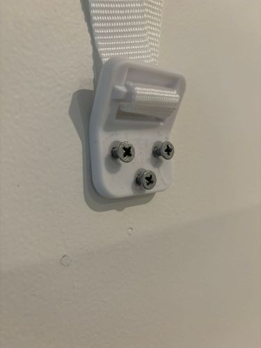

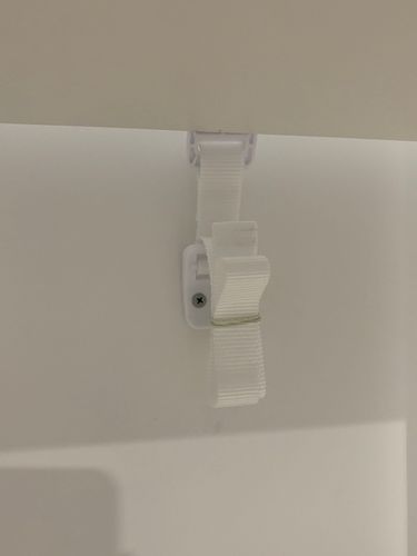

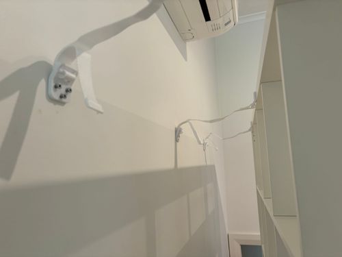

And yes, the bookcase is now successfully (and hopefully securely) attached to the wall.
I will say though, those screws still made hard work of going in. I had to drill a pilot hole for all of them, and I gave up trying to get them in any further on this particular strap - they simply refused to budge, and my Phillips head bit kept slipping.
I figured it would still anchor pretty well and I do actually want to be able to remove them in the future if need be, so I stopped at that point.
Thanks for all your help, everyone!
I do wonder if, in hindsight, it would have been simpler to get those brackets @EricL mentioned and drive one hefty screw into each stud rather than having to drill three smaller holes as required by the DreamBaby straps. Anyway, let’s hope the next project is smoother.
