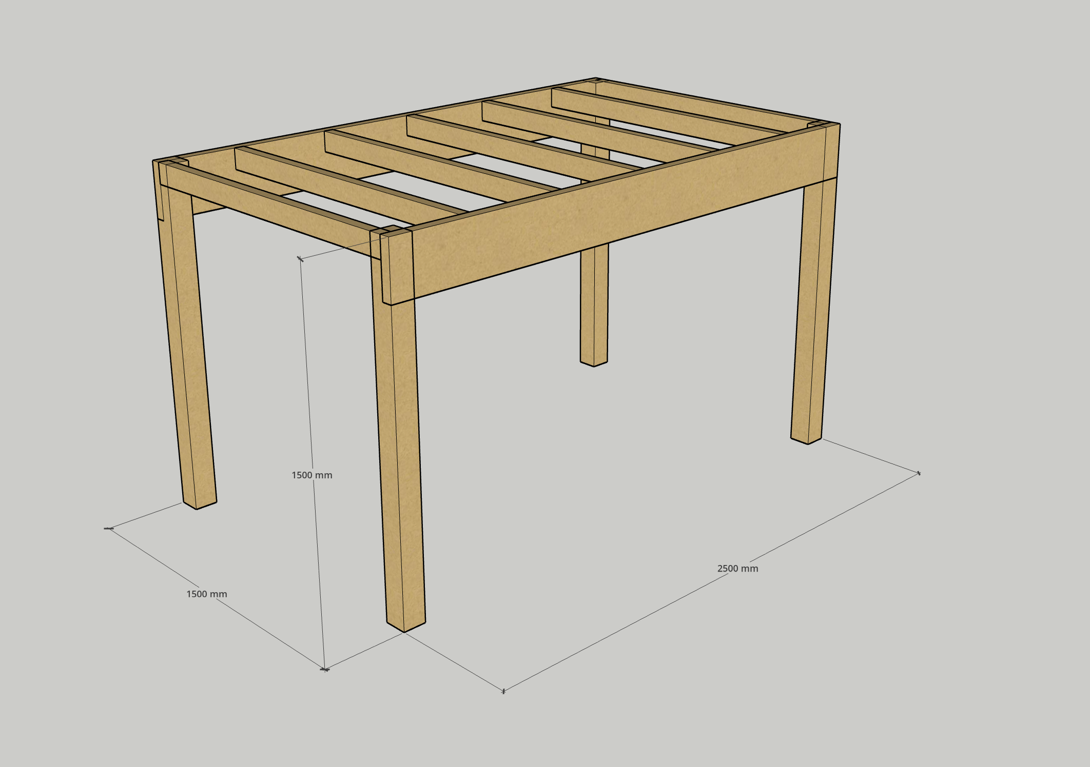

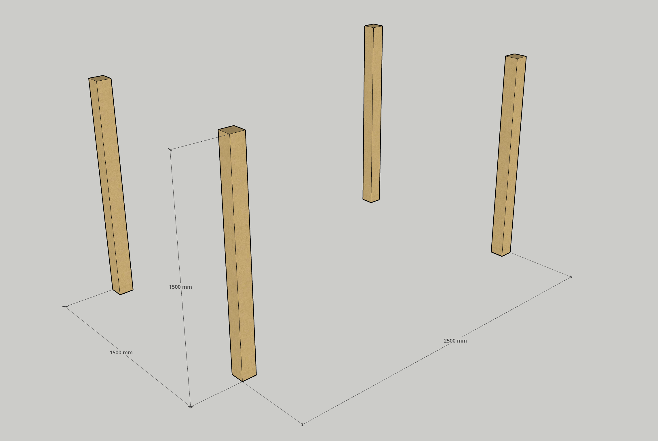

Any structure like this needs to start with posts. I'd suggest something like a 100x100 timber post would be suitable.

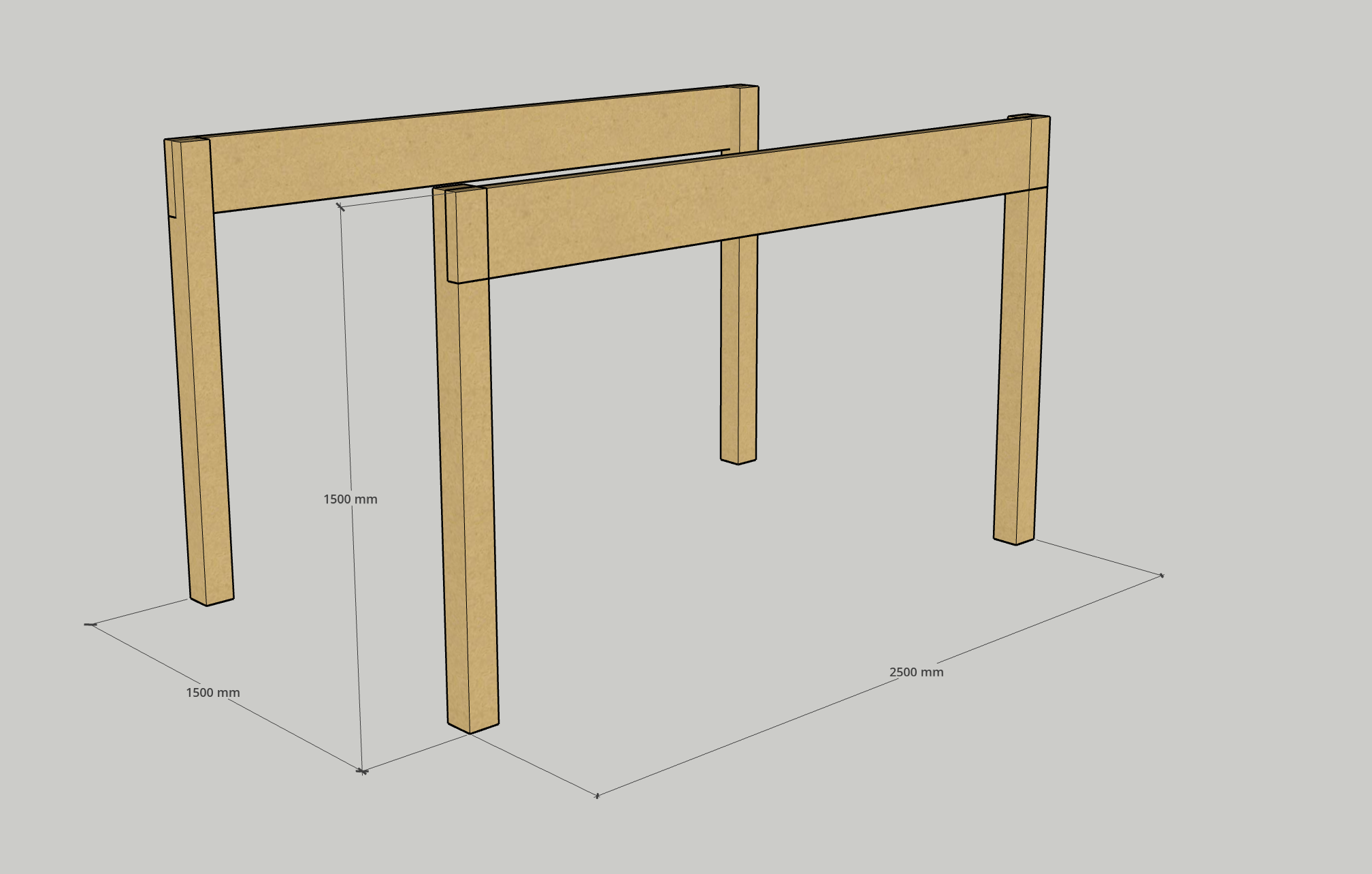

You would then, essentially, be building an elevated deck, so we can use a Bearer Span Table to work out the calibre of timber needed to span longways between the posts, which at 2500mm long, would be fairly large. You would be looking at something along the lines of a 240 x 45mm. You would need one of these bearers to run between the posts on each side of the bed. They will attach to the posts with cup head bolts

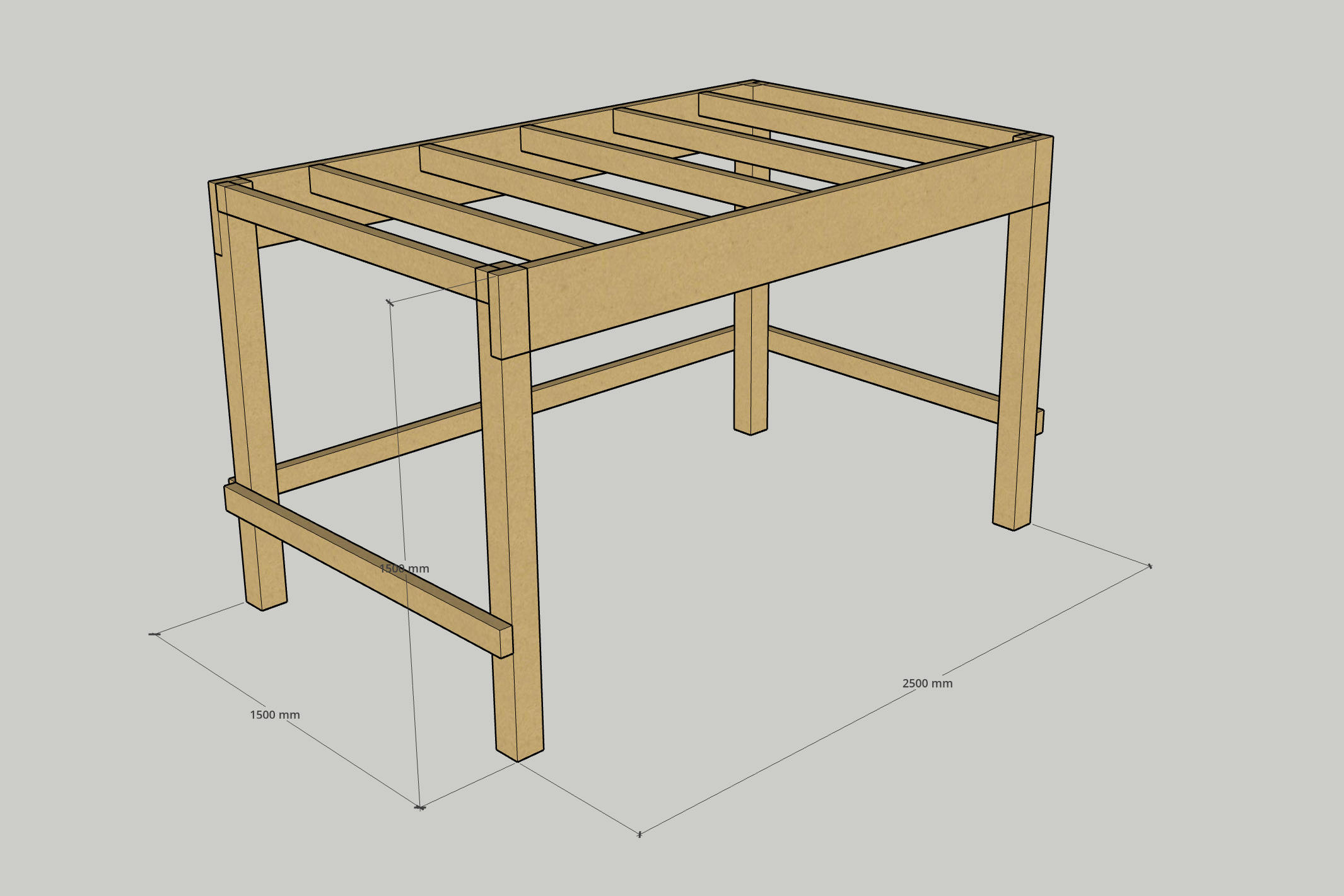

Any timbers that span between these bearers would be treated like the joists on a deck, so we can use Joist Span Tables to select a timber capable of spanning that distance. In this instance, 90x45 timbers spaced at 450mm intervals along the length of the bed will suffice.

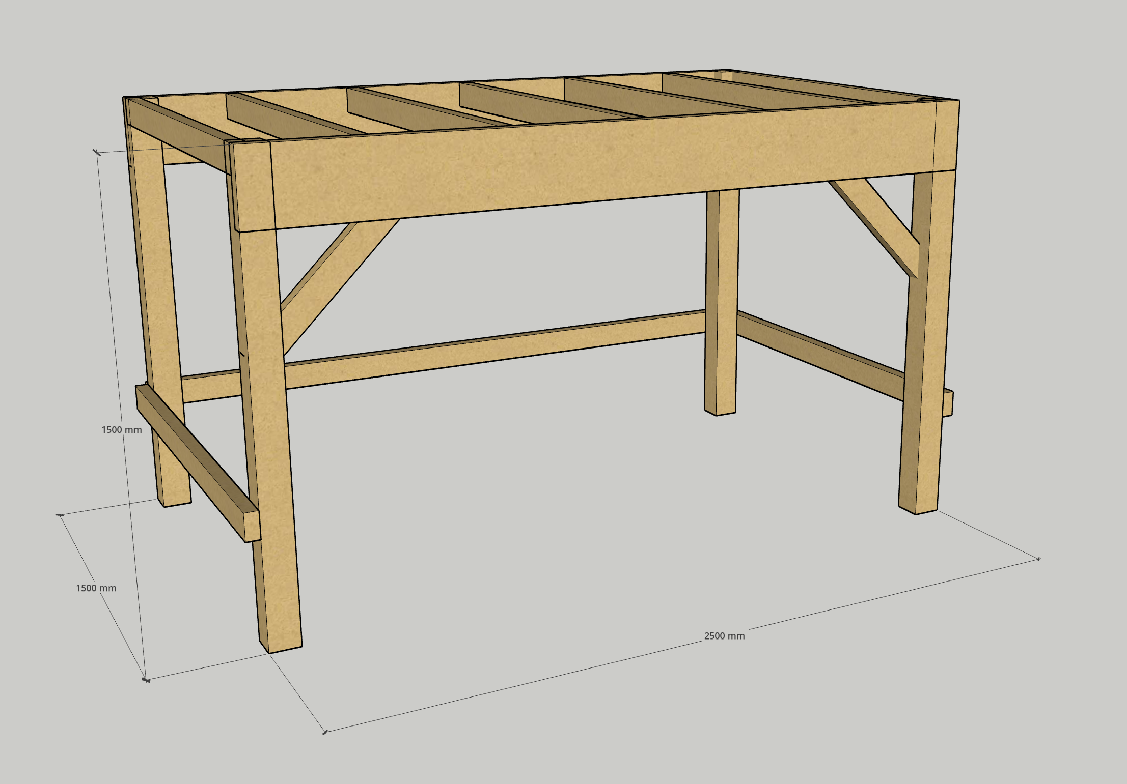

You would then need to laterally brace the posts, as any movement at the top of the structure will be amplified down the posts. This can be done by adding braces 450mm above the ground.
To have at least one open side without the braces, you would need to add angled braces to help with that lateral bracing.
You could then add a ladder to one end and paint it how you like.
