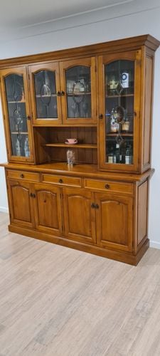

Hi, I have this big hutch/buffet and I want to change the colour of this. At present it's quite shiny and the top layer seems to be quite sturdy as it doesn't scratch easily. Just want some help in regards to how to start and what to do? Is this a big job or can it be done easily? Thanks

It's a big unit, so the amount of work you'll need to put in will reflect that. There's nothing technically challenging about the project, but it will take some elbow grease and time.
Typically to prime and paint over varnish, you must sand back the glossy coat entirely. Fortunately, products like Dulux 1L PRECISION White Maximum Strength Adhesion Primer allow you to paint over glossy surfaces with only a light sand. It can be applied without sanding, but it's best to do a test section to ensure it adheres adequately. If it were my project, I'd at least lightly sand all the contact surfaces, like the benchtop and shelves. Once you've applied the primer and allowed it to dry, you'll be able to coat the unit with a water-based enamel paint.
You might like to check out: How to upcycle a bedside cabinet. I use the Max Adhesion Primer to coat over a similar timber to yours.

An electric sander would be easier, @pash81, though there are plenty of details on the cabinet that you'll need to sand by hand. Remember, you just need to scuff the surface if you're using the Dulux Max Adhesion primer, not sand it back to timber. A 180-grit sandpaper would be sufficient.
If you've never sprayed before, then I wouldn't use this unit as your practice piece, perhaps do some trials on something less important. I certainly wouldn't recommend you use spray cans. A quality brush or a fine nap roller will do a great job for this project.
You don't need to clear coat as the enamel paint is quite durable. You shouldn't drag rough or sharp items across any painted surface; that's the same as benchtop paints. You could clear-coat the water-based paint with a water-based polyurethane. The Dulux enamel is certainly glossy, but that would be up to your own preference whether it's enough.

Question 1- I would probarly suggest to use a fine sandpaper, from what @MitchellMc was saying the paint he suggested would work with that.
Id make sure there are no flaky pieces of varnish left tho.
Question 2 - probarly use a brush, Lots of different planes of surfaces (or a small roller) pretty much what you feel comfortable with. Make sure you dont paint the inside runners (top and bottom parts of the draw) as it will possibly make the draws stick.
Question 3- For the last question it depends on the paint you choose I would think. Id rock up to the bunnings paint station and see what they have. There are way too many to choose ![]()
Hope this helps and looking forward to seeing the project unfold.
