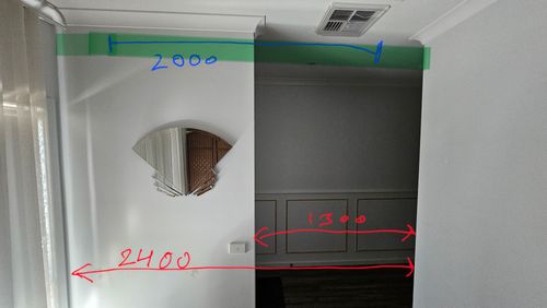

As soon as we enter our home from the front door, on our right we have an entryway to a small study. It doesnt have a door. It is 1300mm wide. I have my office set up there and would like the option for some privacy when I'm in the zone. For reference, I have attached a picture of the entry as seen from inside the study.
*Overall width of wall - 2400mm (in red)
*Width of opening - 1300mm (in red)
*Barndoor hardware rail length - 2000mm (in blue)
*Possible location of a header board (green highlight)

Hi @arian10daddy,
The short and simple of it is, yes, you could hang a barn door here, but it would not be simple to do.
You could, in theory, attach something resembling a header board, but due to the 1300mm unsupported span, you would need to use framing capable of covering that span. For that sort of span, you would be looking at something like a 140x45. You could fix it to the wall on the left, utilising every available stud, but you would also need to fix it into the framing on the right side of the opening. This could be achieved with a Joist Hanger, as long as there is sufficient framing behind the plasterboard to accept it. To confirm this, you would have to remove the plasterboard and add additional framing if necessary.
A better option would be to build a bulkhead across that opening, but this would bring into play the evaporative cooling vent, as it would need to be tied into the ceiling framing. This would give you a much cleaner solution, but it would mean a lot more work to move the cooling vent, frame up the bulkhead, fix it into the ceiling and adjacent walls, then plaster and finish it.
Either of these options is possible, but they would not be a simple case of screwing a board in and then attaching the barn door.
The next issue is the width of the opening. Standard barn doors are 1000mm wide, so you would need to either build one yourself or have something custom-made. There are longer tracks, like this Rolltrak 3000 x 40 x 6mm Barn Door Track Matte Black Side Mount, which could help with the range of motion issue, but it would need to be cut down to fit the space.
Once again, this is all possible, but it wouldn't be simple.
If you are committed to the job, then it is certainly achievable, and I'd be happy to assist, but something a bit simpler, like a ceiling-hung curtain, might be easier.
Allow me to tag our knowledgeable members @Nailbag, @AlanM52 and @R4addZ to see what they think.
Your main issue here is the aircon vent. With that relocated or split into 2 (I'm assuming it was put there to serve both spaces) all would become so much simpler, you could even frame up the gap to take a standard door Or make the opening narrower to take a standard size barn door.
Hi @arian10daddy,
Pull across curtain like the have in hospital wards ![]()
Low cost, easy to install and can be removed at a later date with four small holes to patch up.
I am also looking at that ceiling vent and whatever it is (heating, cooling or both) you will still have it coming into your study..
If you don't like that idea my next suggestion is a bifold door.
