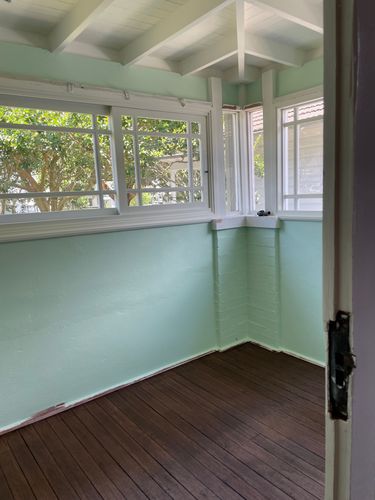

Thanks for the quick reply. Here’s some photos. Ignore the skirting boards! Is it necessary to fill the gaps at all? The previous filler seems to have disintegrated and is crumbling, so I’m trying to decide whether I need to chip it out and start over, or just ignore the gaps and seal it.
I’m a total novice, so learning as I go. Not sure what the consequences are if I do a half-baked version versus ‘doing it properly’.  Appreciate the advice.

As these gaps are between the floorboards @ilovelucy8383, it means you need to be a little cautious. Any floorboards that move seasonally can cause issues with the finish. Even if you fill these gaps with Selleys No More Gaps, there’s a chance that continued movement could lead to the Hard Wax Oil cracking along the joint. Because the oil cures as a rigid coating, it doesn’t flex with the timber, so areas with movement are always a little unpredictable.
The same consideration applies if you used a non-flexible filler instead: the filler itself might crack rather than the topcoat, but you would still see cracking in those areas. Essentially, gaps between boards are always tricky because of natural timber expansion and contraction. If the appearance of fine hairline cracks is a concern, it’s worth weighing whether to fill the gaps at all or to monitor how the boards move over time before applying the Hard Wax Oil.
