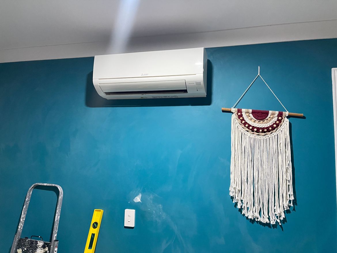

In below image, green shadow is the wall, I would like to do VJ paneling.
How do we finish around the edges indicated by the red line ?
How do we finish the VJ panelling before the skirting board shown in the image below ?
What could be the easiest way to work around the areas such as this power plug ?
Thank you.
How do you (we) go for VJ panneling around the AC and the window frame in this picture,?
I am picking up this project after so many years.
This is my first time installing VJ panneling and I think it is going to be tricky around AC unit.

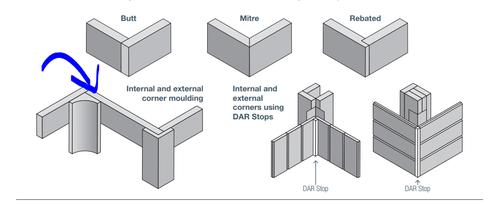

4.) Since I am going to corner to corner, I believe I can put following in my either sides of corners ? Do you have any product in mind with I can use from bunnings?
5.) Do DAR stop and moulding work differently? I still don't understand how do I use them around the Window frame, corners or even at the top?

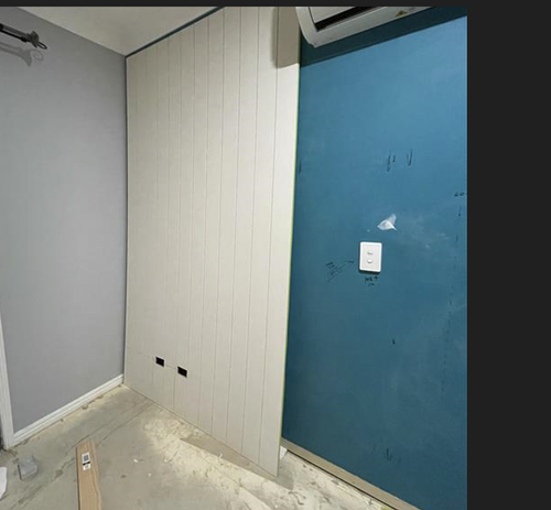

This is my progres so far, holes created for switches and skirting removed

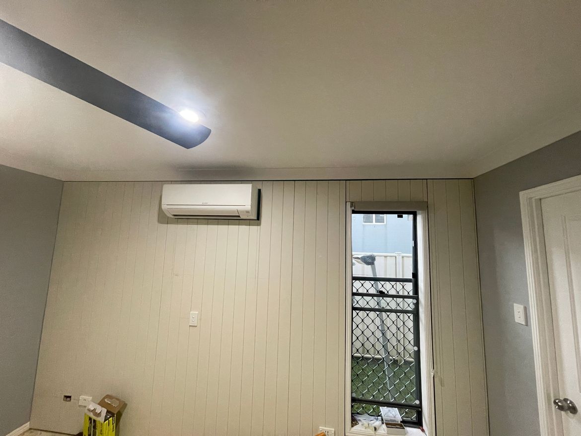

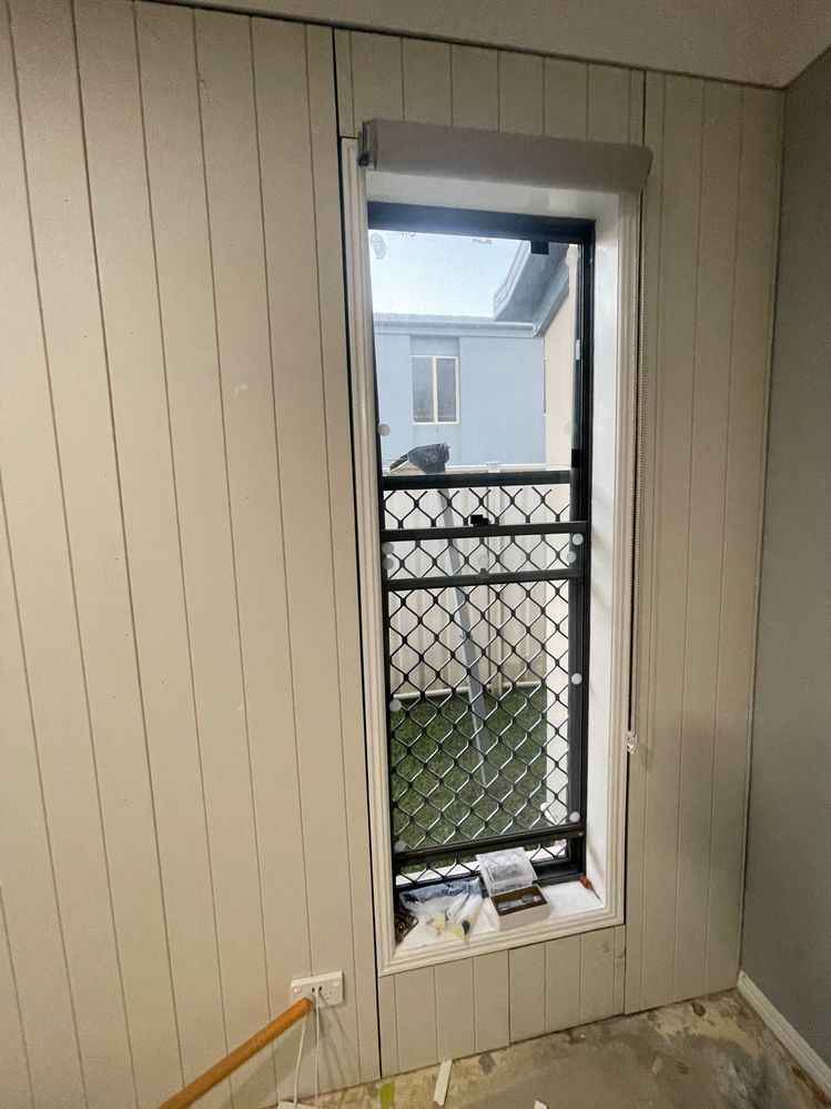

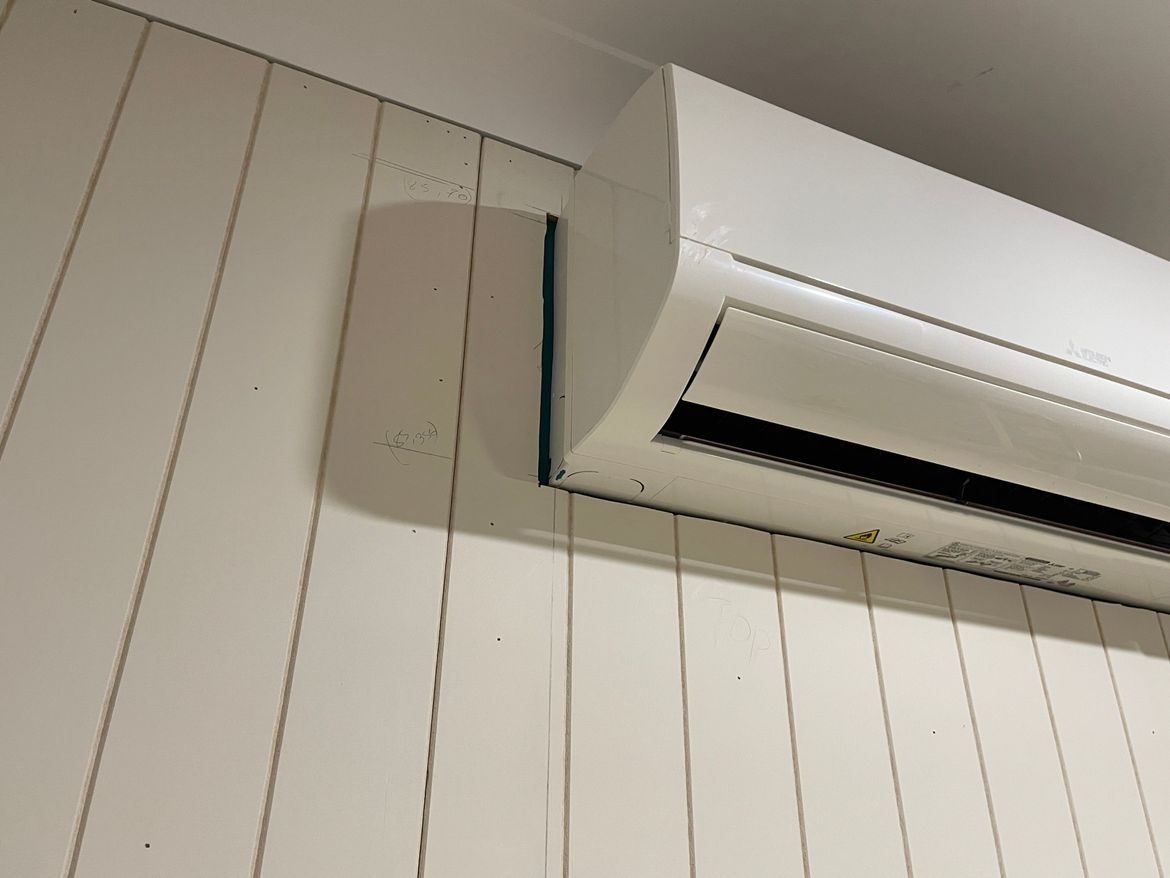

@JacobZ @MitchellMc This is my progress so far, not sure good or bad
. I am happy with my progress being my first time as well. However, there are gaps to fill. I have gaps around Window Frame, top of the panel, around the AC unit and between panels as well.
The gaps are ranging from 5mm to 10mm as well. Not sure how to tackel this situation.
Not sure if it is good idea to fill such a big gap with No Gap filler or if there are any other moulding or framing alternatives.
Here the panel is perfectly lining (flushing) with the thinkness of the bottom of the cornices and window architraves.
Help !!!
Thank you in advance

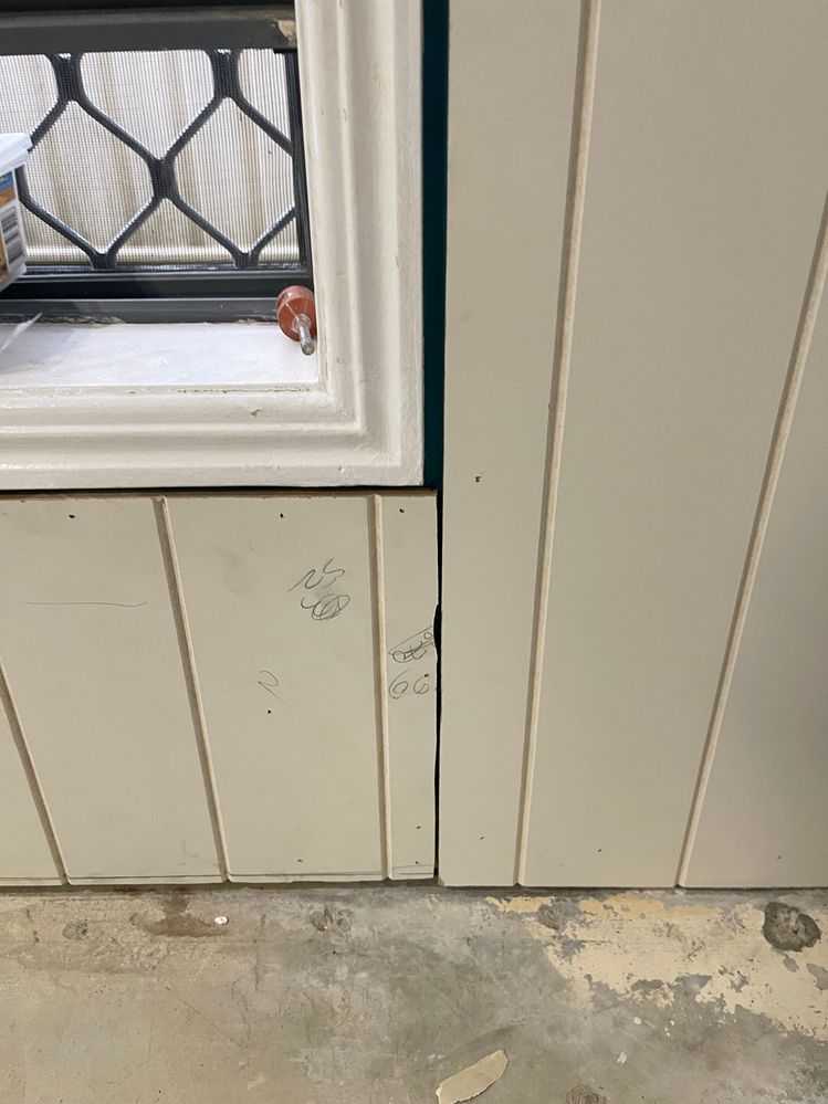

Gap underneath window frame
Approx. 10mil gap between bottom of cornices and top of panel
Gaps around window frame

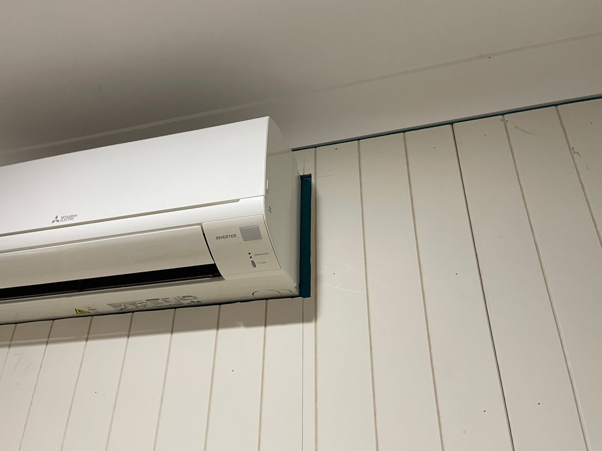

Gap around AC unit (Right side)
Gap on left side of AC unit.
gap bottom of window frame

Hello @Sugar
My apologies for not seeing the rest of your query. I suggest covering the window gap with scotia as Jacob had recommended in his last response. I propose looking at 66 x 18mm 5.4m White Moulding Pine FJ Primed Bullnose to cover the window gap and the aircon gap. As for the gap between sheets, I suggest using Timbermate 500g Earl's MulTflex White Exterior Flexible Filler - 500g. It is a unique exterior filler as it is flexible and therefore won't crack with movement. The top portion will need to be filled in with a silicone filler such as Selleys 475g No More Gaps Interior Multipurpose Gap Filler. The bottom portion of the panel can be covered with a skirting board of your choice.
