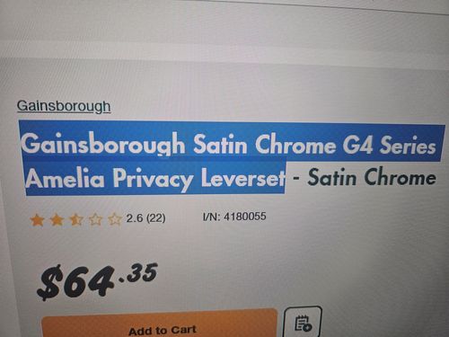

Hi, the latch is stuck in the door frame and can't get the door open. The handle wouldn't move the latch and the door couldn't close. Somehow the kids slammed the door and now the door cant get opened. Have removed the handle and everything but not sure where to go to from here to get the part out of the wall so the door can be opened again. Can access the otherside through a window (which is how I got the kids out). This is a bedroom door. Any advice to how I can get the door open so I can sleep tonight would be great thanks!!
