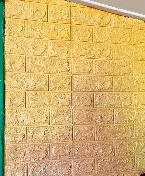

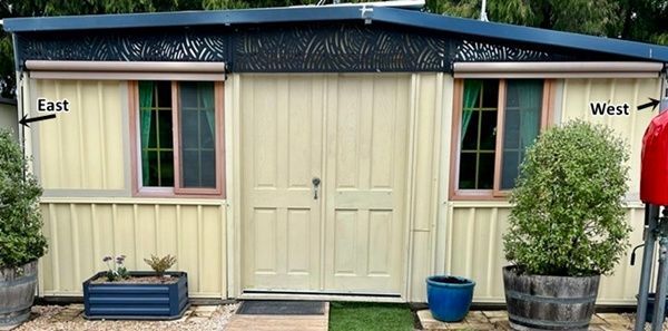

Thanks for your response and suggestions - I'm trying to add some insulation to a window wall of a cabin that the original builder failed to insulate without having to remove the exterior or interior walls and realize it might be a non starter. I recently had Earthwool R2 batts placed inside the west wall and an Earthwool space blanket under the corrugated roof which has made a bit of difference in the hot temps of summer but the NE (front) wall gets quite warm and is a bit more complicated to insulate (pictures attached). Gets quite cool inside as well, usually down to about 8-10deg in winter without heating. I have thermal curtains on the windows and exterior roller blinds when necessary which help a bit. The wallpaper I plan to use is a 4mm thick foam self stick textured brick that will also be painted over so not looking for a smooth wall (attached photo). This alone is unlikely to insulate so the extra 4mm liner was thought to help even if a little. Could the Ametalin be attached with silicone glue or is this not feasible? I may just have to use the wallpaper by itself and deal with the lack of insulation for now unless I can come up with another option that does not require wall removal (might have to eventually consider a pro-job adding inside slats, Ametalin then wallboard over top, a slight loss of room width).Having the west wall and roof insulated is a big plus in this 18sqm room. (East wall will be insulated with R2 batts later).NE wall.jpgwall brick wallpaper.JPEG

Do you think you might have enough depth on that wall to install insulation panels over it instead? Something like rigid foam panels are usually around 25mm thick, provide a higher R-value than the liners, and would create a flatter, more stable surface for your foam-backed wallpaper to adhere to. It would add a bit more bulk to the wall, but not nearly as much as a full internal wall rebuild, and it could be a good middle-ground option if you're trying to avoid major works while still improving the room’s thermal performance.

I've had a lot of luck using silicone adhesives with high heat and weather exposure impacts so it might be something I can consider. I would have room for the 25mm panels especially since the internal window frames and door frames jut out about that much and they are cost effective - my handyman suggested that but he was a bit reluctant to do such an installation, something a more professional installer could do. This might be the most sensible option - I'm still mulling over importing the UK Wallrock products as I now find they may not be restricted - jury still out. But now I have several options to consider so I thank you for all your suggestions. We will get there eventually!
