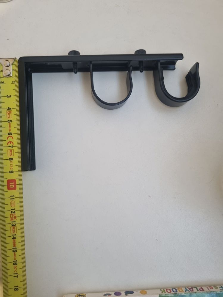

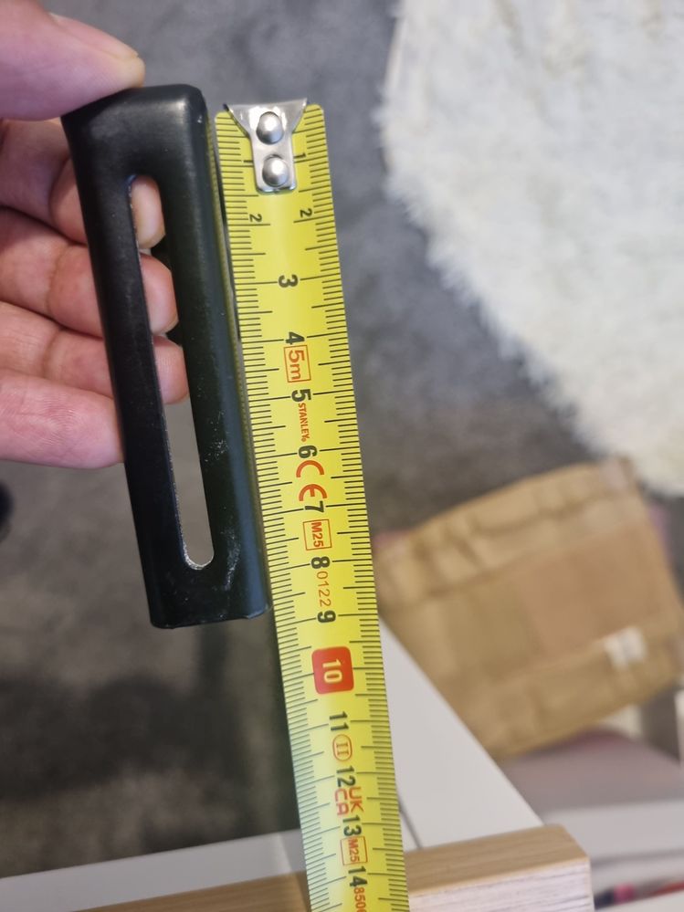

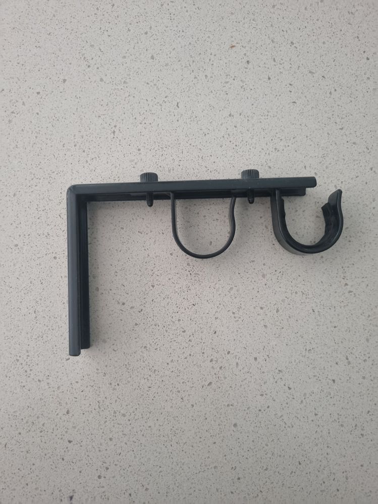

Hi, I need some help installing brackets into a steel stud, the brackets were already there, installed by previous owners, as I added the curtains, the whole thing came off, it was drilled in the plasterboard only there is a picture added, additionally just figured out the whole house has steel studs so need help, I have added pictures of the whole in the plasterboard and the brackets for more information,20250903_140019.jpg20250903_134445.jpg20250903_134427.jpg20250903_134652.jpg
additionally if I was to drill in the steel stud is a toggle anchor good steel screw better?

The first step is to check whether there’s a steel stud directly behind the spot where you want to install the curtain bracket, and a stud detector will come in handy for that. If there is, the strongest option is to use metal self-tapping screws, which will go through the plasterboard and bite securely into the stud.
If there isn’t a stud in the right position, you’ll need to repair the damaged plasterboard and then use heavy-duty anchors such as expanding toggles, which are generally the strongest fixings for plasterboard alone. In your case, it looks like toggles may have already been used and the plasterboard was weakened, so the extra weight of the curtains caused it to fail. The two main options are therefore to either locate and fix directly into a stud for maximum strength, or repair the wall and use new toggles or move the bracket to a stud position for better support.
