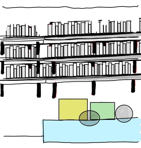

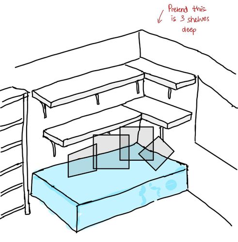

We're creating a home office in a small bedroom and want to install wall shelves (see chicken scratch sketch below for context).
We have one long wall with a short adjacent wall with a window that, ideally, we'd love to max out for additional shelf space otherwise its just an unusable corner (this is not 100% needed though).
The original idea was just to blue-and-yellow Scandi store approach this - pre dressed and schmicky shelves (we don't need anything fancy) are either 80cm or 120cm. We'd ideally like the brackets to be evenly spaced for aesthetic purposes but that's not strictly necessary either. Not keen on floating shelves nor tackling a custom build, the former for strength reasons and the later for time reasons, so looking to either:
a) Source timber in a length that suits the wall and stud span (don't mind a cut/match up in middle, so long as the brackets allow for a really solid, strong shelf) - but the depth of the shelf needs to be at least 25cm, and I can't seem to find an option this deep on website. We'd get this cut to size and finish/stain/seal at home, but that's about the extent of our abilities. This is our preferred option.
b) Bung up a pre-made shelf product (like the Scandi store) with all the same allowances made for stud placement and including a little overhang etc. Perhaps there's a Bunnings product that better fits our measurements? The less 'join ups' the better (hard to ensure they're all level with lots of separate pieces).
I can't for the life of me find a solution to either option. Either I can't find a hardwood length at least 2.6-2.8 m with a 25cm depth, or I can't find an individual shelf length that allows for even bracket placement on the studs. Like I said, not fancy people, don't need this to be particular moustache-twirlingly-satisfying, they just need to be solid, even, able to withstand the weight of a full shelf of books, and just a sprinkling of aesthetics.
Oh, and in case the images aren't clear, the more bookshelf real estate the better, so they'll start around 50cm from the ceiling and probably be replicated 3, hopefully 4 shelves down the wall (for whatever span solution we can gather).
(LHS wall is the front face of a BIR, which has drawers that extend out beyond the doors, so the left end point of the shelves will have to be fixed in roughly that spot).

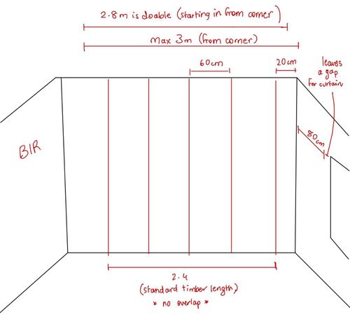

Stud placement and wall length

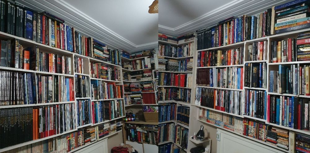

But just to throw it out there - a homemade component system that can be made piecemeal. Each component is randomly sized and you go at your own pace and each piece has a backing which does mean stud location is crucial. Attached by coach bolts which are hidden by books. They're just 295mm radiata pine with a whitewash and polyurethane finish.
No brackets required.

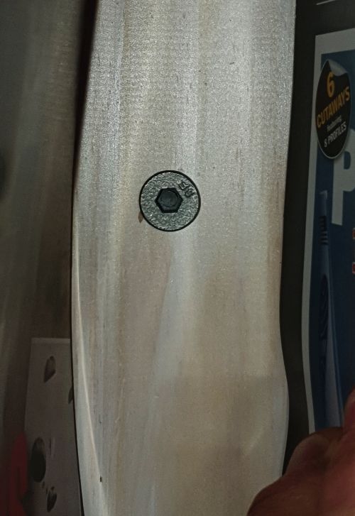

Trying to visualise how you've put this together - are you able to pull books out of a section and take a close up of the coach bolts? Ta!

"Randomly" was wrong. The bookcases were made depending on the size and weight of the books and there is symmetry of sorts. But I guess it is like constructing Lego against a wall. And not just 295mm depth - there is 150mm and 250mm as well - all depends on the book sizes. It was a wraparound concept that started in one corner with a clockwise movement that negotiated a window, built-in cupboards and a door with some of it being floor to ceiling. No space was deemed too small.
Around 15 bookshelves were built and attached by their backing. I forget the Bunnings product - but 12mm tongue and groove pine, securely attached piece by piece to the backs with glue and MANY screws.
Positioned with clamps and support poles - and screwed into the studs, not with Coach heads (memory loss), but 100mm Type 17 Bugle Timber Screws.
This was all 6-7 years ago. Not for everyone I guess - but for me, it kept a few tonnes of books and magazines off the floor.
Cheers.
Screwed to studs.
