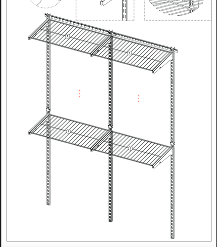

I'm using the Kmart Double Storage System (only $20 on sale - yay) which has provided the pictured (Image 1 and 2) positioning guide for the hang track and recommends:
"Secure the hang track Beam sticker according to the horizontal line with the condition that at least one wall strip can be attached to a stud. Also ensure that the mounting holes of the wall strip align with the location of the stud. Note: If wall strip cannot install on the stud, please make sure at least one type A screw be used on the hang track with the stud"

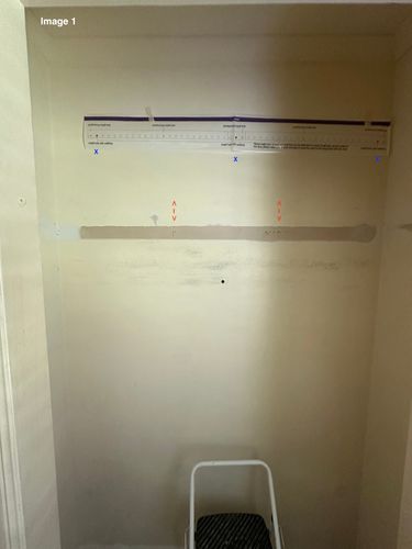

Unfortunately I'm struggling to align the wall tracks (written on sticker or blue 'x') to any studs. I've marked two of the studs with red arrows RED and know there's likely some in the corners of the frame but are too close to the wall to be of use.

But similar to the similar to the Bunnings Flexi Storage systems with baskets or sliding racks, the vertical tracks need to be a particular distance apart so I'm not sure how to progress with putting the vertical wall tracks on studs. Thanks @Nailbag, normally if it was just plain track shelving they wouldn't need to be even but I'm pretty sure this application will need this spacing - correct me if I'm wrong though as that would solve this very entire issue quite quickly!
Like in the image, I can shift the temporary placement sticker that's currently on the wall left or right, but I can't get any of the 'hole with wallstrip' placement locations (I've also marked these with a blue 'x' on the photo) to align with the stud, particularly with the wall being enclosed/in a cupboard.

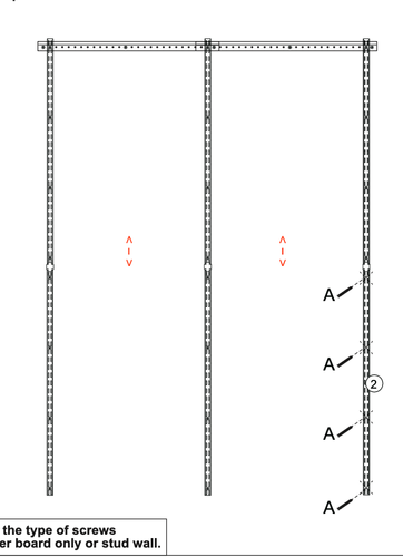

The idea with these kinds of shelving systems is that the hanging rail at the top is fixed into all available studs, and the vertical strips are screwed into a stud if one is available or into the plasterboard with the provided anchors where they aren't.
Unfortunately, the width of the components for this system means the vertical strips need to sit in certain locations, which don't seem to line up with your studs.
The only solution I can think of that will have it sit flush with the wall and have at least one vertical line up with a stud is to move the system hard up against the left or right corners. Depending on how the house is constructed, there is usually a stud in the corners. There are no guarantees because it is all down to the order in which the house was constructed, but I would be checking those corners to see if a stud is available.
The alternative, which the instructions for that product do allow for, although not ideal, is to simply use the plasterboard anchors. As long as the hanging track is securely screwed into the studs, the vertical rails will be supported by the studs, just less than they would be if they were directly screwed into them.
