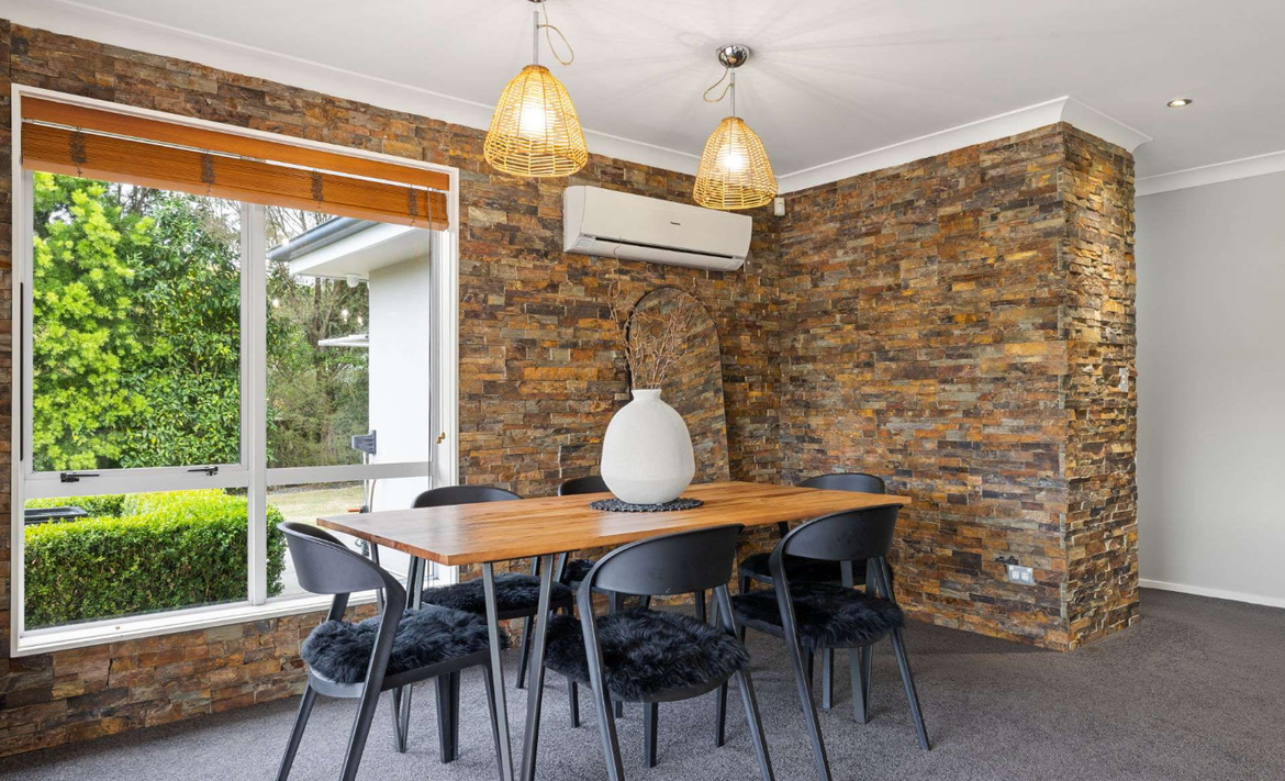

Is it possible to limewash an internal schist wall?  The schist is quite an orangey hue.  Would painting be better?

From my perspective this would be a two-step project. First the wall has to be painted to provide a neutral base for your plan on limewashing the surface. Once the wall has been painted a neutral colour or the colour of your choice, you can then plan on what colour combination to use to get the limewash effect you are trying to achieve. I propose using Dulux 1L PRECISION White Maximum Strength Adhesion Primer on the tiled surface. For the topcoat, I recommend looking at Dulux Wash&Wear in low sheen or matt finish.
If you are successful with the limewashing you will truly have a unique wall finish. Not only is it limewashed but it has the distinct quality of having an irregular surface that gives it a very organic feel.
Here is a handy step-by-step guide: How To Get A Limewash Effect With Paint
