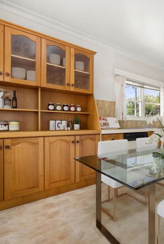

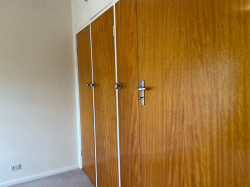

also grateful for any advice you might have for restoring kitchen cabinetry or wooden doors to remove the old reddish stain and varnish and make them lighter to match a black but sort of colour .

In regards to your doors, it all depends on what you are painting over it. If you are staining it again then all the old stain and sealer must be removed and the door sanded back to timber. But if you are painting it in colour, you can sand the surface of the door and then apply a stain blocking primer to prevent the old stain from rising up.
I suggest finding a spot in your house where you can leave the cabinetry under cover and protected from the weather. It's important that it be protected from the elements while you are sanding it down as moisture will damage the timber if left unsealed for too long.
