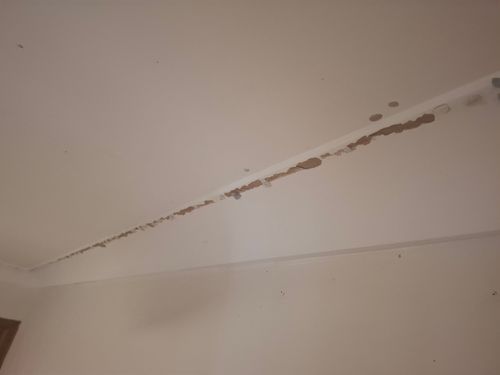

Hey all, I've attached a couple images of a cornice that has had its paint peeled away from a bunch of blu tack.
It doesn't seem to be more than a couple mm deep but at some point runs a meter or so.
I was going to sand the area down and use some smooth coat filler in those areas. Once dried, sand and prime it.
Is this the right way to go about it? Or will i need more course filler i.e spackling? Do I need special cornice paint for it?
So many questions! Thanks guys

You'll want to start by tidying up the MDF by removing any loose material and sanding any hard edges. You can use 120-grit sandpaper to do this.
When it has been tidied up, you're going to want to seal the exposed core of the MDF prior to any filling. MDF is extremely absorbent, and if you apply filler straight onto it, the moisture can swell and distort the fibres. For this, I would recommend a shellac-based primer such as Zinsser 369g B-I-N Primer Sealer Stain Blocker Aerosol. This will lock down the surface, prevent swelling, and give you a stable base for repair materials.
Once the primer has dried, the UNi-PRO 500g Smooth Coat Skim Filler will be be a great choice to fill the voids. They are not particularly deep, so there's no need for anything more specialised.
You would then follow the process you have mentioned of allowing it to dry, sanding the filler smooth, then priming and painting. You can use the same Zinsser B-I-N primer over your filler before painting.
