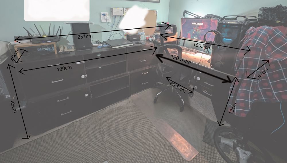

I'm making a new corner desk to replace my flat pack solution I'm currently using, one side is going to be pretty long at 251cm, while the other side will be much shorter at 160.5cm long.

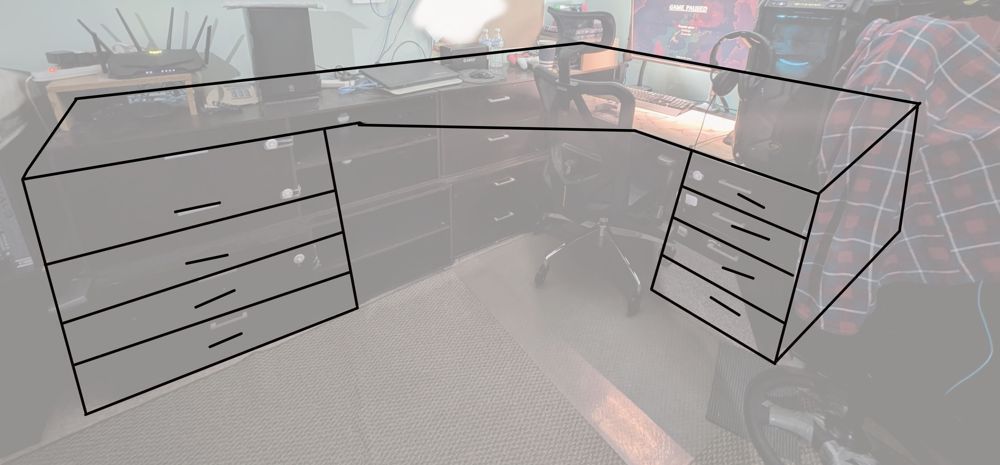

And join them together with a mix of dowel and wood glue at the center after staining/painting them black, I am planning on using a couple of thin layers of epoxy because I'm trying to replicate a look similar to this: https://youtu.be/gun6TksQqqI?si=AZ3OnzmoJt37QtvR  (one dark layer, one clear layer after gold leafing). I will then use dowel/glue/pocket holes/screws to attach the desktop to my drawers.
Each end of the corner desk will have drawers which will give it extra strength. I'm playing to put a wide variety of electronics, monitors, PCs, etc... on the desk, the PC will probably be the heaviest thing I'll sit on it, is this going to be strong enough with just dowel/glue/epoxy at the center where the two corners will meet? Or is there a better method? Is 18mm going to be too thin for this project? Or should I be looking at something like 26mm (which I think would be thick for a desk)?
These are the current desk/cabinet measurementsThese are the current desk/cabinet measurementsPlanned desk, drawers on both sides, desktop joined at the centre/corner with dowel, glue and epoxy.Planned desk, drawers on both sides, desktop joined at the centre/corner with dowel, glue and epoxy.

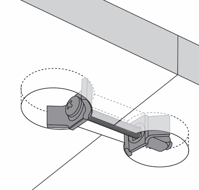

I propose using the Specrite 2200 x 600 x 26mm Golden Teak Acacia Multi Use Panel rather than the thin panel. The benchtop holders I'm about to suggest will only work with the thicker benchtops. I suggest going with the glue along with the benchtop joiners which are stronger than biscuits.
Below are benchtop holders you can use to link the benchtops together:
These benchtop connectors all work on the same principle with the steel concave washer pulling the benchtops together. These are the most commonly used benchtop joiners they provide excellent clasping strength and keep the benchtop straight.

Thank you, that seems like a better way of joining them together, I assume it's installed similar to this video:
https://www.youtube.com/shorts/iDyGdsYvH8U?feature=share
Re: Best way to safely join these desk tops without sagging/breaking?
Hi @UltimateGattai,
Yes, that video shows exactly how to install them.
You'll need to route out a channel and a rebate for the connectors to sit in.
