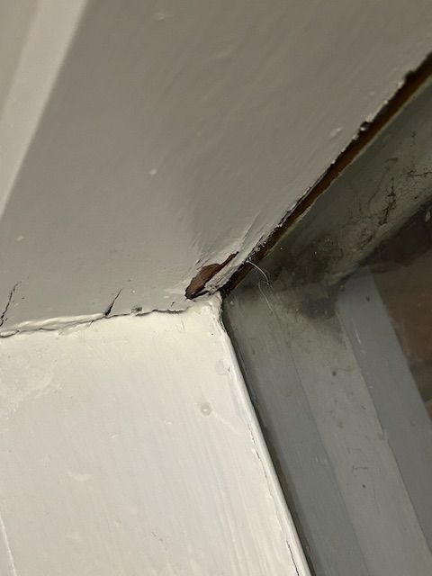

Hey everyone
I noticed a puddle of water on the floor below this leak today. When I looked further, it was water dripping down. These windows are wooden framed. I live in an older apartment on the second floor, so there's no way to go outside and inspect where the water is entering without a ladder (Don't have one)
I know ultimately its probably best to replace the frames but i'm not really financially able to do that, is there any way I can fix this myself? And what products would I be looking at getting if so?
Thanks everyone

I sent through a quote request to a place and they quoted $953 for this. Based on your experience of fixing things, is this normal? It seems absolutely ridiculous to me. The issue does seem small with the key being that it has to be investigated from the outside.

No, no ones actually come by to check it out yet. It's been hard. I've emailed a bunch of places but its been way harder than I thought. The quote came from a place which asked me to send through a photo - the same one I posted here was what I sent.
Also, just re the above. Can a plumber actually come and look at my windows? That's so weird to me, thought they'd only be dealing with pipes but I really am out of my depth with anything DIY which is why i'm here lol. Also just for clarity, I'm the very top apartment so there's noone above me that could be creating this issue. It's also been advised that this is my responsibility to rectify as its only affecting my windows.
