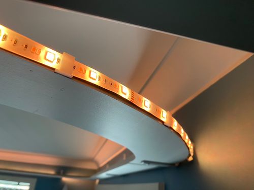

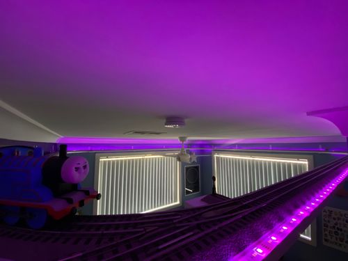

I’ve attached a few pictures with the lights up. The light strip is some 10M Arlec grid connect from Bunnings. It’s not quite long enough to go around all four sides of the room so I’ve settled for three sides (not sure if I can extend this past 10M)
In the corners I used the included joining strips to move the lights from the top to the edge since you can’t easily bend the strip horizontally.
I’ve also used adhesive clips to attach, not the backing strip so it’s easier to remove/adjust.
Cheers

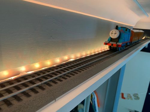

Hey @TedBear - 100% I agree the original picture looks more professional and almost somehow realistic, especially with that exposed sleeper type track. I suspect it is as was suggested two layers of MDF with thin ply to form the box shaped support section.
I am not sure how stability would work suspending something like that from metal rods either - It must work though as it is not the only suspended layout I have seen online for sure. Other people suggested i should make the track shelf floating with I guess metal rods into the beams and holes into the side of the shelf so there is no visible bracket.
When tacking this project though - one of the main considerations was simplicity and ease of build. If this was going to require very precise cutting and accuracy it would end in frustration. I was able to go from a couple of test brackets with a plank of wood to the finished project between the 9th of December and late January in my spare time only. I had to buy and learn to use a Jigsaw for this project!
As it was, trying to use a doweling jig so that I could have dowels between each board section was giving me heart palpitations from frustration. In the end I re-did all of the dowels twice using two different types of jig and they still don't line up very accurately. But I went with the old saying 'Do your best, silicone the rest' and just pushed on. The track is not exactly centered on the shelf, but the shelf is wide enough to accommodate some leeway and still keep things working. Also the track I have used 'Lionel FasTrack' although costly and only available from US (Amazon), it clicks together and is very strong when making fine adjustments, it won't kink or buckle like other exposed sleeper track types.
I ran our larger Christmas train 'The Polar Express' up here to check track clearances etc.. and dang - a big train with a lot of details and illuminated carriages REALLY looked awesome running around the room. I think Thomas will be relegated to a crash test train and we will replace him with something a bit nicer.
