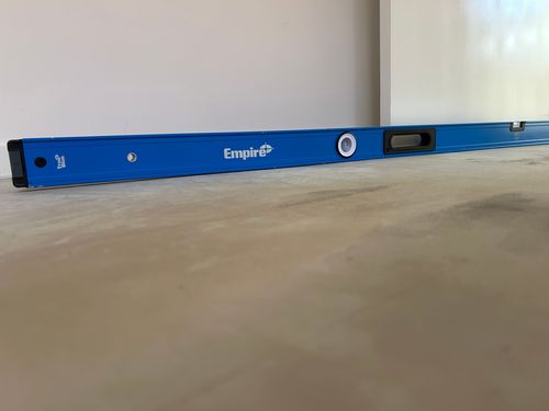

i have done the levelling though i noticed that when you enter into the bedroom from the coordinator the levelling is slight off. I think there is 4mm gap however when i used the 2m spirit to check the level in the corridor or in the bedroom everything is perfectly level however the entrance is where if you keep the leveller either mostly in bedroom or mostly in the corridor that when you see this gap. This doesn’t happen in other bedroom. Any advice what to do there?

Re: self leveling concrete floor
Please see the attached picture.
If you place the spirit at the entrance of the room then you can see the gap at the end.
But if you move leveller back a bit into the corridor then all is levelled at the start but at the back there is a gap as you can see in below picture
if you place the leveller inside the room then you don't see the same gap which you could see in first image.

Hi @maulik,
It's a little bit larger of an area than I had pictured. I'd say your best option at this point is to just apply some Lanko Ultraprime 124 Surface Primer over the first layer of self-leveller and then pour a second coat over the low point to bring it up to the same level.
Is there an opening on that side where, if you poured another layer of self-leveller, it might run out? If so, then you'll have to block any openings to ensure the leveller stays where you want it to.
You'll also have to either remove the skirting boards or protect them to prevent the additional self-leveller from damaging them.
