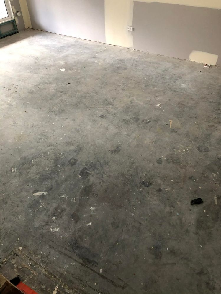

Hi Experts,
We are currently redoing a sunken living and the builders have informed us that the concrete slab (built in the 80s) has a high moisture content and this isn't a major concern but something to be away of. We are thinking of doing some DIY water proofing, not so much to keep water out but to create a barrier between the concrete slab and the carpet that will be laid. What steps/ products should we be using and as we get a lot of rain in our area do you see any concerns with doing this? The room is roughly 6m x 6m.
Thanks.61d522a9-efdc-4360-a883-693045bd0137.jfif

As we aren't necessarily needing to water proof it and more trying to create a barrier between the concrete with high moisture reading and the new carpet, do you have any suggestions that can be diy?
Re: How to water-proof concrete slab?
Hello @jdok
Water or moisture coming from the bottom of the cement slab means that there is no moisture barrier in the slab and this is why you are getting a high moisture reading in the concrete. The only product that I'm aware of that puts up with negative hydrostatic pressure is Dunlop 4L Damp-Proof Moisture Barrier. All the other products are top sealers which are made to prevent water from entering concrete.
