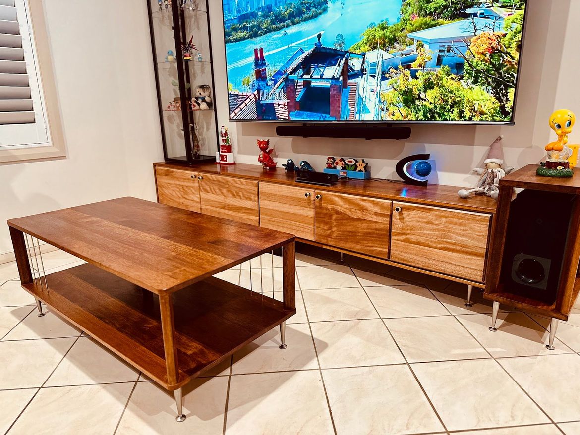

120cm x 60cm x 43cm merbau coffee table with brass accent, polished to perfection (and reflection!)

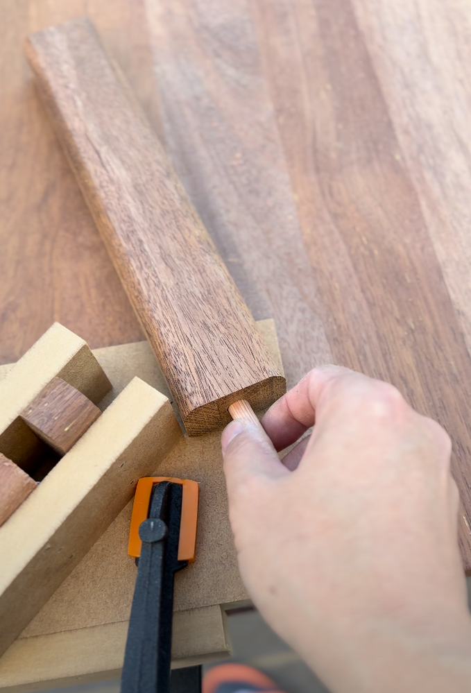

  • I first cut the offcuts of 33mm merbau into 50mm wide, around 400mm strips - all 5 of them
  • I then run them through the router to make them oval shaped - for imperfections just sand them flat with a 60grit sanding pad
  • I then cut them using a drop saw to 290mm long (so I can have 5mm in both panels to house the brass rods)

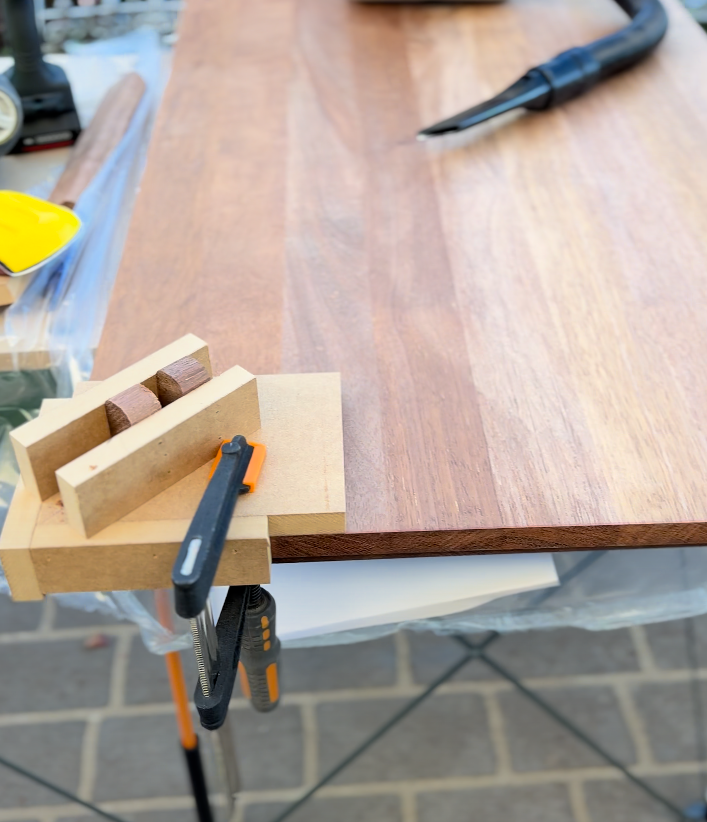

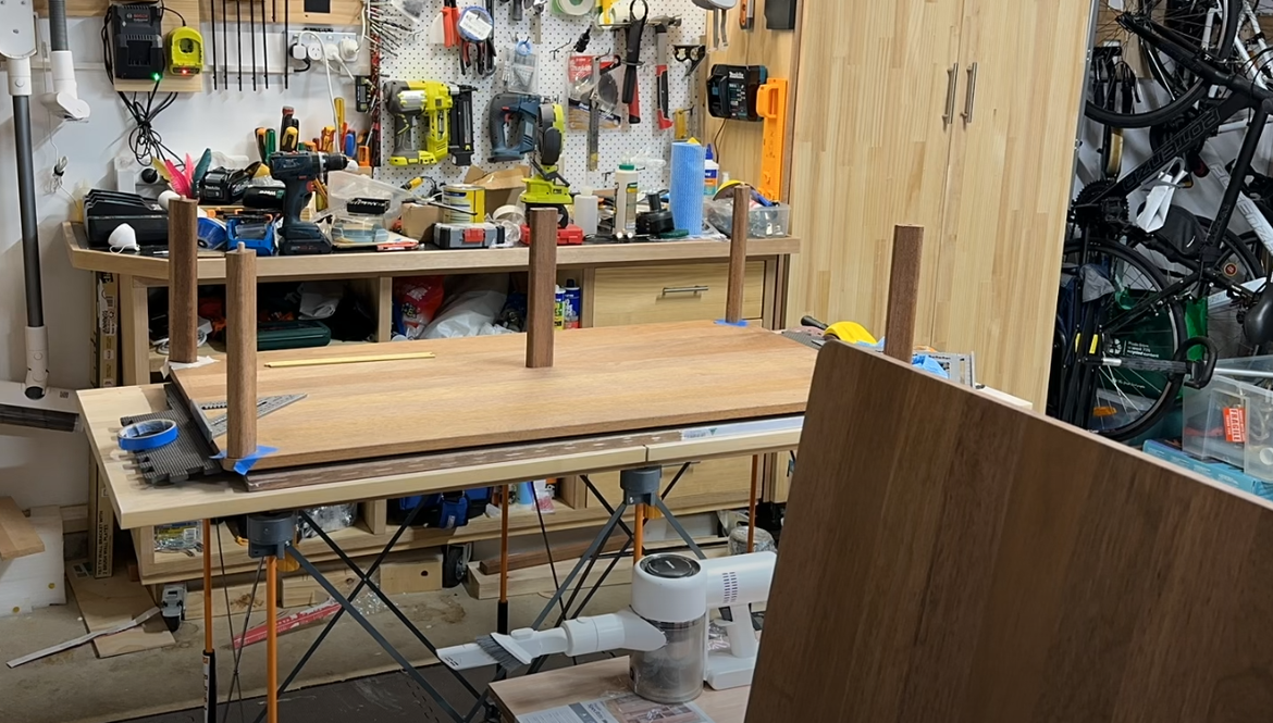

  • I drilled holes for dowels using a self made jig that works both for the supporting posts as well as the panel itself
  • I stacked them together and rounded the corners by cutting a little triangle off with a handsaw, then smooth it out with 60 grit sand paper and a random orbital sander

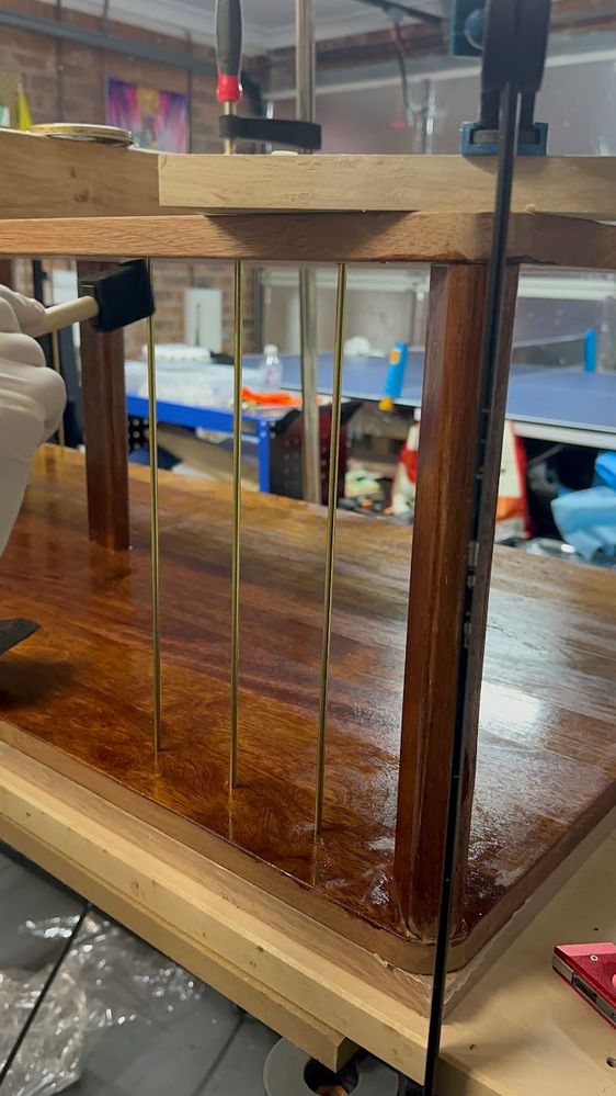

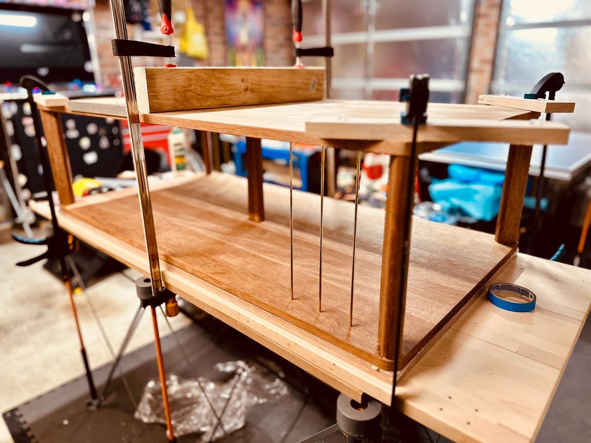

  • I predrilled 4mm holes to house the brass rods, aligning them perfectly with the posts
  • the posts were aligned 45 degrees to the sides to create a lively presentation

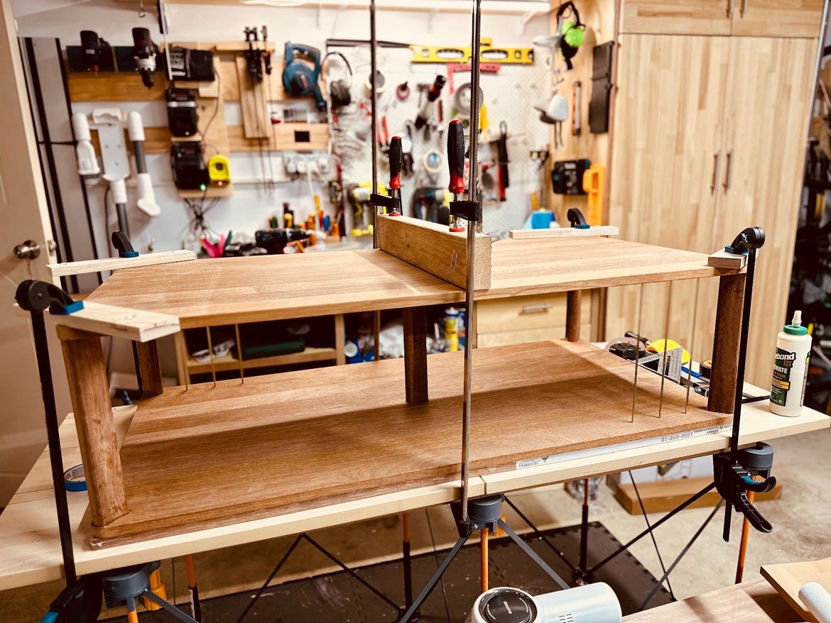

  • I first laid the bottom panel down and glued the posts with dowels into the predrilled holes
  • I then added glue over the top of the posts, with wife's help I was able to put the top panel on the posts.
  • Then I added a lot of clamps, wait over night for glues to dry.

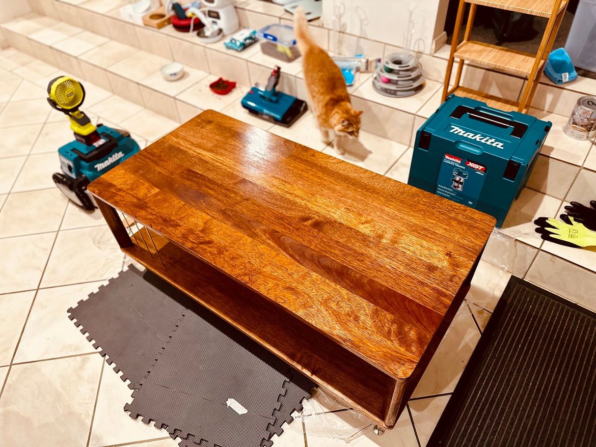

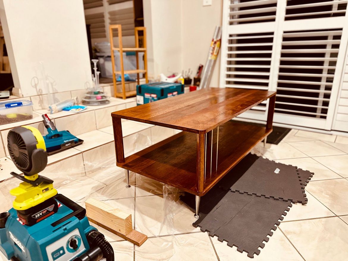

  • while waiting for the glue to dry I already started applying danish oil on the bottom board and the posts
  • then on the second day I applied danish oil on the top panel as well, on both sides so the wood won't bow
  • I applied total of 3 layers of danish oil, in between I waited for them to dry for 4-6 hours, lightly sand down the surface before applying the next layer
  • I waited for the oil to dry for 3 days (get close to the panel and if you can't smell oil, it's dry)
  • I then applied 3 layers of water based varnish, again between each layer I waited and sanded
  • To achieve a mirror finish, I polished the surfaces with turtle wax and a polish pad using my orbital sander
It came out really nicely and the table top is buttery smooth.

Thanks Eric, indeed I built the tv cabinet and subwoofer housing first then took the idea I had for the subwoofer housing further to make the coffee table.
The doors were all made from a 1800x405mm okoume panel and the sides were chamfered with a trim router, I also used danish oil plus water based varnish for the finish. Danish oil really compliments the golden tone of okoume and the while thing looks amazing in person, photos don’t do any justice 😂
