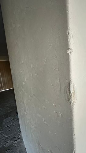

our renovation has moved slowly since we can only work weekends, and we’re finally looking to move in - sans bathroom 🤯 it’s all part of the adventure!
with the walls above, they’re all patched with rapid fix and I’ve skim coated the white set with Gyprock Top Coat (Gold) which has produced amazing results. I just wanted to check if there was anything else I should do before applying the Dulux 3-in-1 prep / sealer / primer?
Thanks so much!
here’s some photos of the before, and then the freshly plastered front entryway
walls
Hi @SensibleHill,
It's great to hear that things have been progressing. For larger areas of plaster filler, it's recommended to go with the Dulux Precision Sealer Binder, which is an oil-based version, instead of the water-based version, which is better suited to smaller repairs.
Apart from making sure that everything is flat and well-sanded, there's nothing else I can think of.
