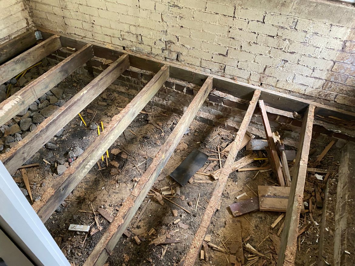

Thanks @MitchellMc. So have I got this right that the thermal layer is attached to the top of the joists directly over the insulation and then the yellow tongue flooring is directly on top? I have access to the area below the joists.IMG_8762.jpeg
Since removing the floor today,  I have realised that a couple of the joists have been also eaten and they will need to be replaced. I also need to raise the floor level because previously there was yellow tongue flooring, floorboards then carpet. Can I just apply two levels of yellow tongue on top of each other to raise the height?
