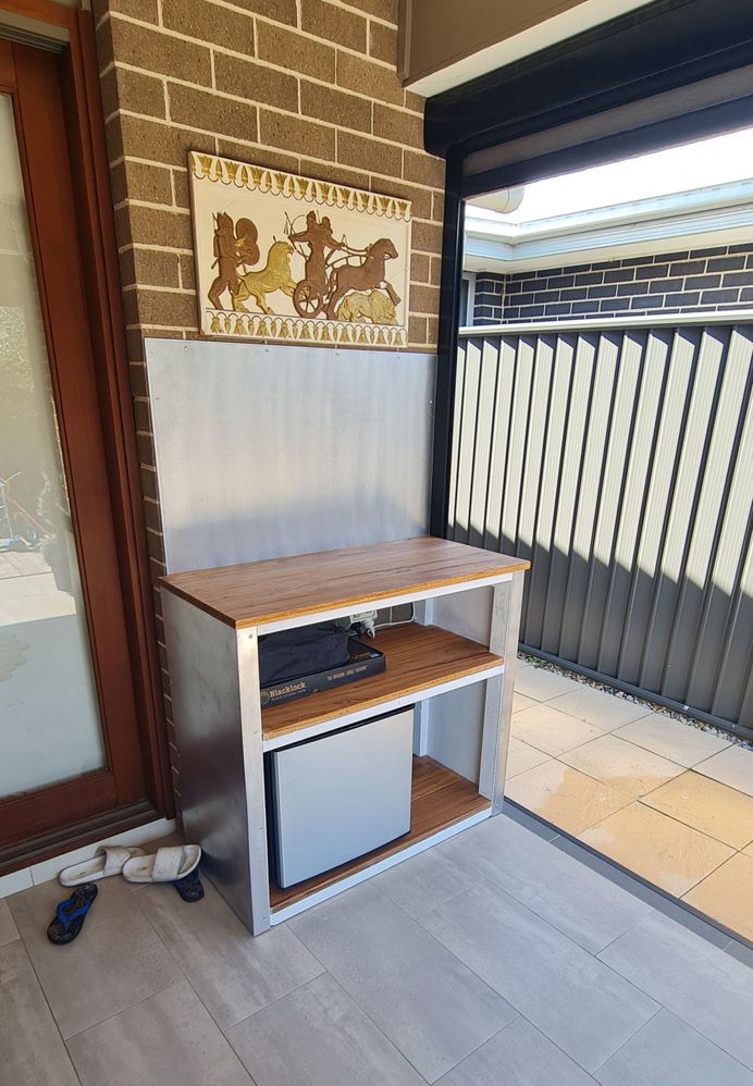

Build a outdoor kitchen bench. As we have a glass window splash back inside the kitchen, when we cook it tends to get very dirty especially when using oil. So we decided to built this in our alfresco to avoid the mess on the splash back.

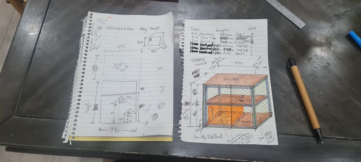

20240330_141511[1].jpg20240307_195821[1].jpgWent to the drawing board and worked out how much we needed for the space as we were limited as the alfresco is small.
Cut all my timber to size. Started to glue and screw up all the frame work.  Cut the 16mm hardwood for the bench top. Originally planned to have doors but we changed our minds and kept it open.  Once all was screwed together, measured up what was required to cut the aluminium side panels and splash back.

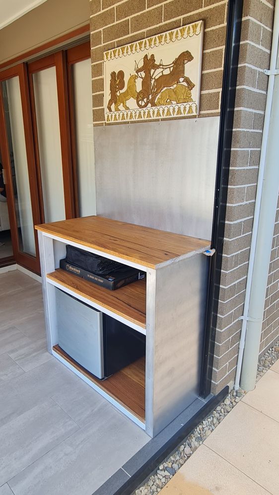

Screwed the frame into the brick work to avoid movement. Using green plugs and 120mm timber screws.
Splash back mounted to the wall and screwed into the brick work for support, using the 25mm wafer screws.
We installed a mini bar fridge and portable gas unit, which we use to cook on.
