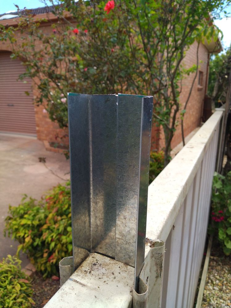

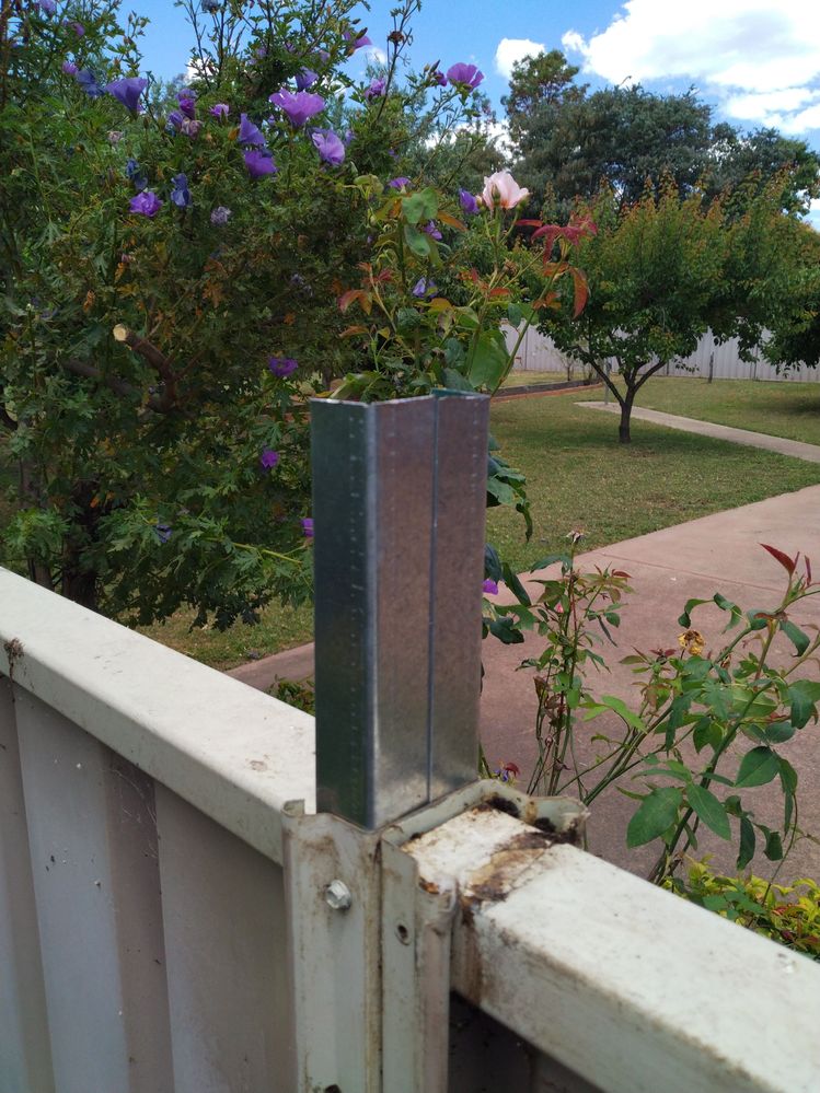

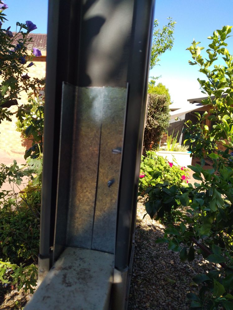

Hi Eric
Here are some photos of my fence extension. It takes a bit of manipulation to get the 2 - 3 x3 x 1.15mm angles into the top of the posts. I have cut the post extensions using an angle grinder from the standard 2.4 m posts. I made them 340mm long and and cut standard infill sheets to 330mm, that left me very little waste. Of course you can make the extension posts and sheets to suit your requirement or leave out the bottom rail if you want a slat or lattice infill sheet. I made a total of 6 extensions for a total cost of $350, all materials bought from Bunnings.
I did 6 extensions for a total cost of $350.
Hi @Baron
Thank you so much for posting those fencing extension photos. What an amazingly creative solution to extending your fence using Australian Handyman Supplies 30 x 30 x 1.15mm x 2.4m Galvanised Pressed, Angle. I wouldn't have it thought possible because of the shape of the post. This is a good alternative to extending Colorbond steel fences.
Again, thank you for sharing your fence extension technique.
