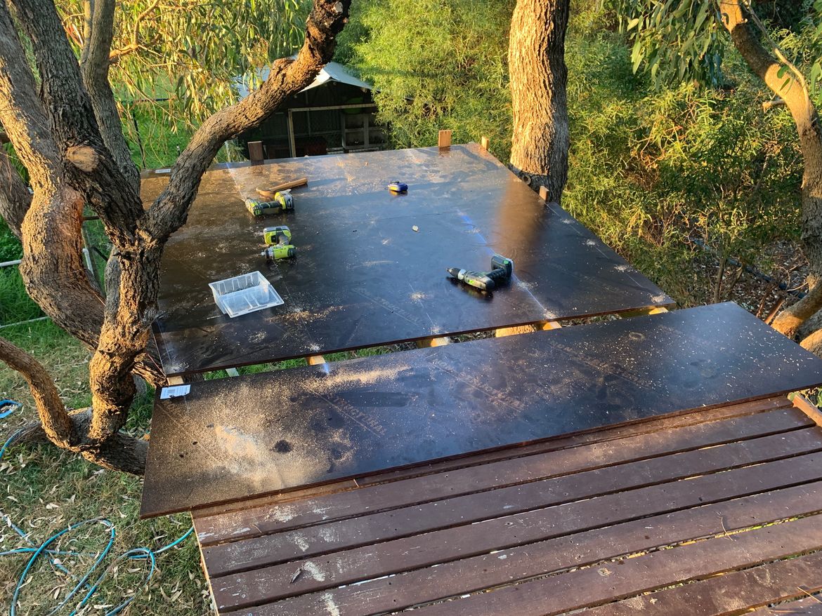

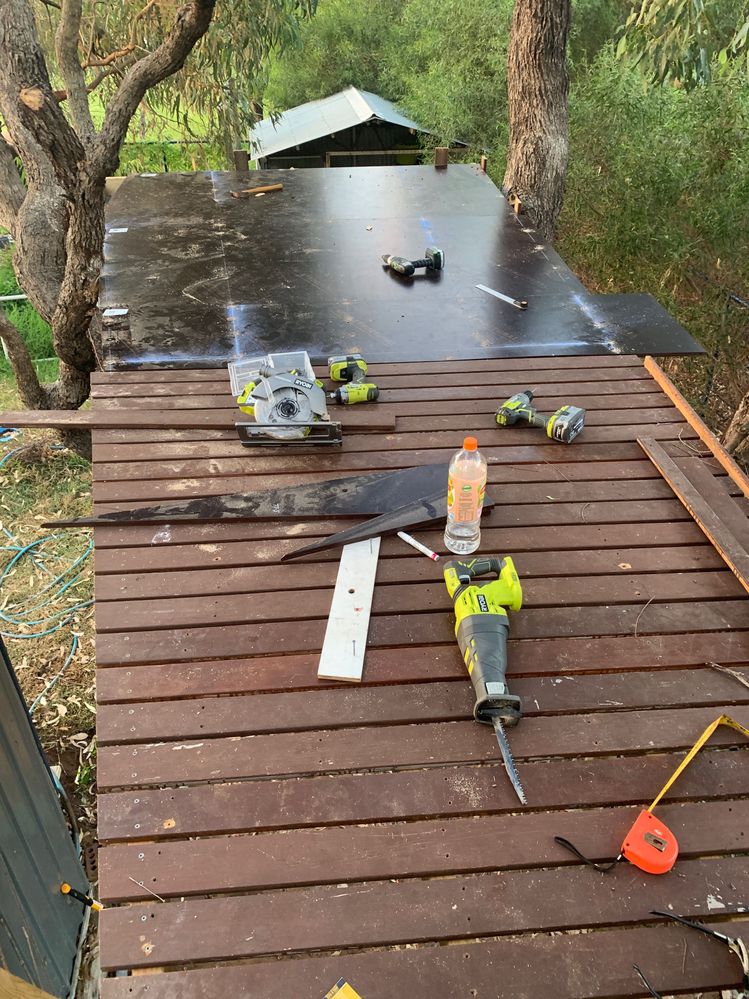

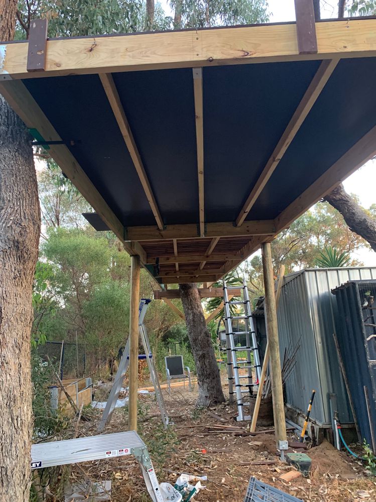

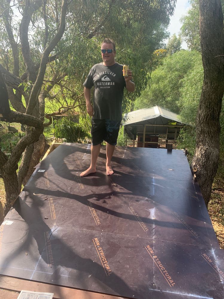

now for the (form) ply flooring to go under cubby part. 19mm film ply. A chalk line was perfect for tracing where beams were underneath !
chalk line very handy for tracing joists
view ain't half bad !

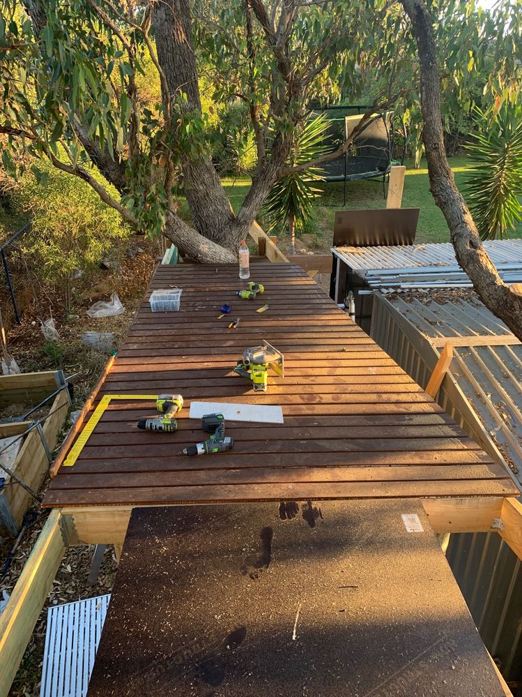

all the flooring done !
quite a behemoth from underneath !
flooring milestone - deserves celebration !

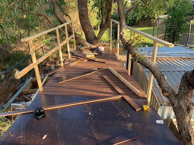

next was railings ![]()

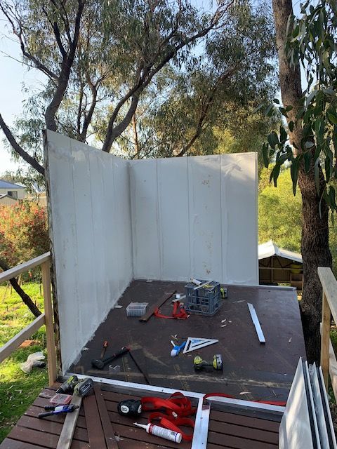

Next - the cabin !!

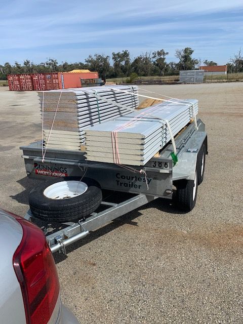

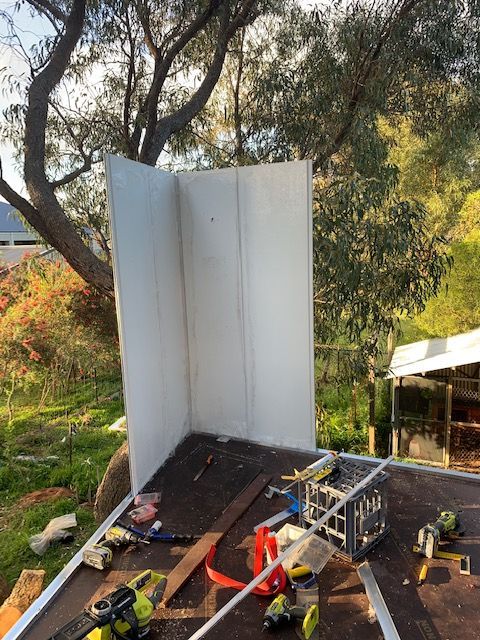

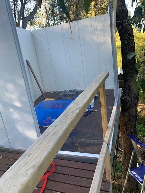

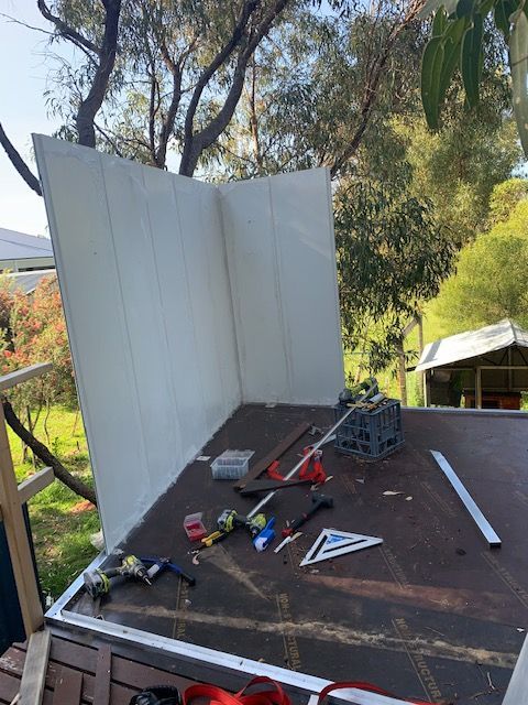

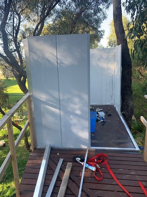

I was lucky enough to score some composite panel from a local wholesaler who had some lengths of 40mm thick sandwiched foam with steel skin. they are interlocking panels used for sectional garage doors (great idea to have insulated garage roller door !- check out http://tigerbuildingsystems.com.au/ ) They had some panels that were water damaged and couldn't be sold for normal use, so I got them very cheap ! - they even cut it to length for me ![]()
(thanks bunno's for the courtesy trailer

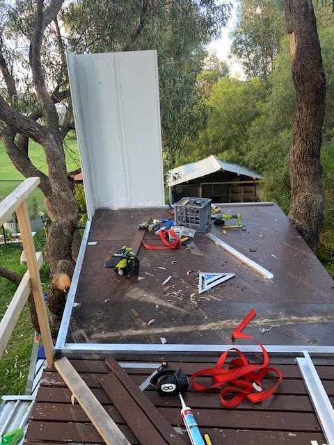

plan was to mount it inside some sectional 'C' Aluminium channel....which would've been perfect....except there was no 40mm channel.... so I had to get 50mmx25mm.... got from Ulrich aluminium - who also cut to size
https://www.ullrich.com.au/
To make 40mm panels fit into 50mm channels....took a bit of thinking; but I discovered that DIY lengths of Flyscreen panel frame are a perfect 25mmx10mm, nice and light, and pretty cheap. This would be used to 'pack' in the panel so it was snug - worked perfectly, very neat, and left no nooks for spiders/nasties to set up camp....
C-channel was screwed to base and through into beams below. composite panels were glued and riveted into channel; and very cool 90o channel joins used for corners, and also for attaching roof later on1st was the trickiest ! - imagine trying to balance this on your own, up a ladder with a decent breeze
gap left for door, and then onto roof ! - closing in the final panel was tricky....but it's all done and solid as a bunker !!
