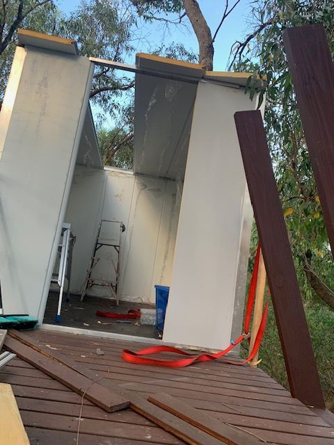

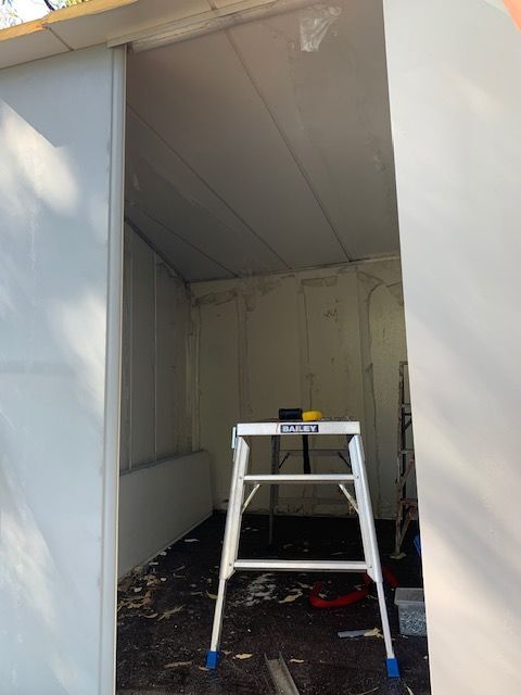

few more pics of closing up the roof
"this much to go !"
success !!!

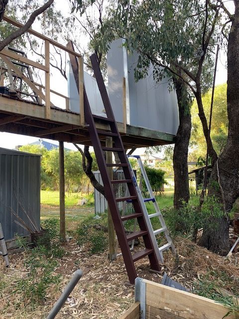

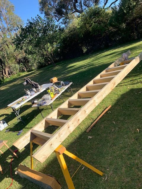

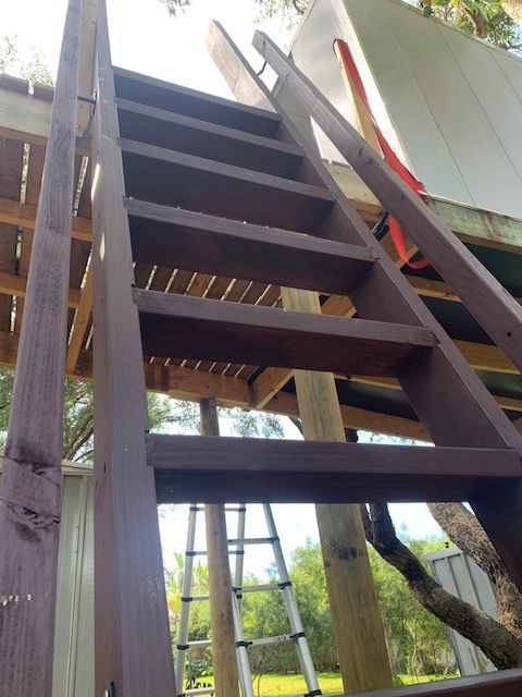

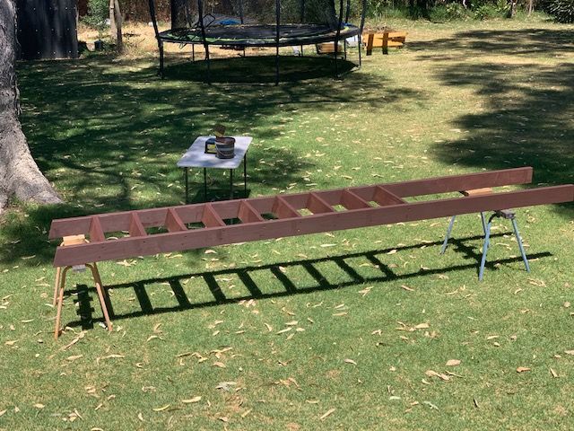

Oh yeah - a keen eye will also notice an addition to the side..... I got sick of trying to haul panels up a ladder and nearly stack.... so fast tracked the 'ships ladder/stairs
made a template and routed out channels for each step.....this was fun carrying down and lifting into place on my own....

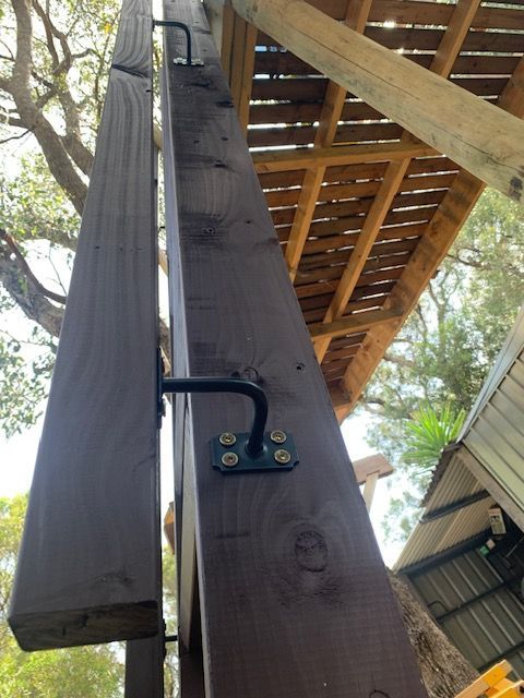

and some grab rails (brackets from you know where !)

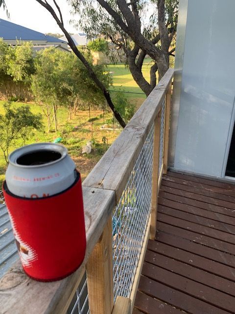

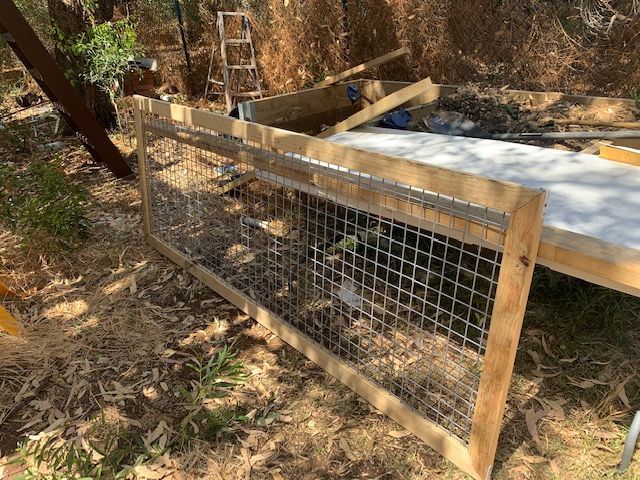

then wanted to make the railing gaps more 'small kid proof'
made a 'pig fence' - routed a channel down the inside length of the pine, and slotted the mesh in place then screwed the frame

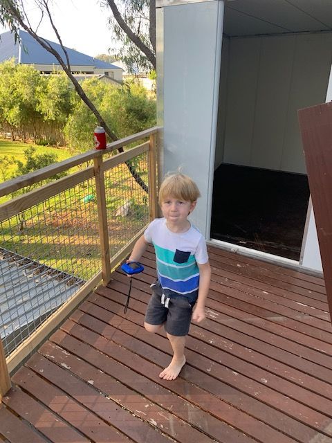

'small child' field testing complete

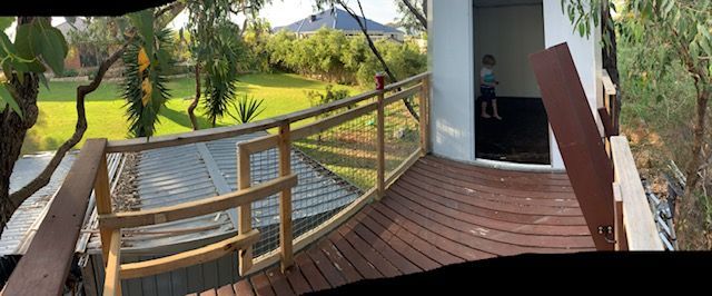

this is about the latest pic - it's essentially functional and safe; I have a window to install into the 'cabin' and need to finish off the railing....
also think a firemans pole at the end of decking is required..and a camouflage paint job on outside to blend in...
top railing is perfect width
