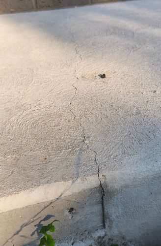

Our concrete apron was completed in September last year (approximately 5 months ago). We’ve recently noticed a few issues, including:
1- Some fine hairline cracks
2- One more noticeable crack along a formed step-down / construction joint (intended for future paving), which has opened to approximately 1 mm
3- Minor chipping along several saw-cut / control joints
We understand that some cracking can occur as concrete cures, however we’re unsure whether what we’re seeing is considered normal shrinkage or whether it may be related to workmanship, joint detailing, base preparation, or ground movement.

Hello @far4733
Welcome to the Bunnings Workshop community. It's sensational to have you join us, and thanks for sharing your question about your concrete apron.
Fine hairline cracks occur when the cement slab dries too fast. In order to prevent this the slab is often kept moist with water slowing down the curing process. If water runs under the slab this could also cause movement and creating cracks on the surface. Since it has only been five months, I suggest speaking to your concreter about these issues.
Can these cracks be fixed or filled? Yes, just in case you are wondering what product to use, I suggest looking at using Gripset Betta 1L Concrete Crack Filler to fill in the cracks. However, I suggest speaking to your concreter first before you apply any type of repair on the surface.
Let me call on our experienced members @Dave-1, @AlanM52 and @Nailbag for their recommendations.

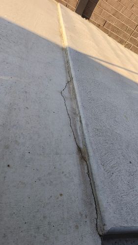

Hi @far4733
I am far from any expert here other than a few things I know such as what @EricL has mentioned being drying to fast. This would only occur though during either extreme heat, or typically from too much curing accelerant. The other is issues with the preparation such as reinforcing mesh and ties.
My first point of call would be with the concreter as the correct method of addressing the issue prior to any escalation. In the meantime, I highly recommend you don't accept or attempt yourself temp fixes as this will only complicate the process. Plus anything you do will not be long lasting structurally, simply cosmetic.

Thanks all for your replies. Just to clarify, our main concern is not only the fine hairline cracks, but also a more noticeable crack (approximately 1 mm wide) that has opened along the formed step-down / construction joint intended for future paving (second photo). Could this be due to absence of appropriate expansion material (for example, compressible foam at the step-down) to accommodate movement?
We have contacted the concreter to inspect the work; however, he is pushing back and has advised that, per his "terms and conditions", he is not liable for any cracking, chipping, or shrinkage, attributing this to ground movement outside his control. He has said this without an inspection.
From an industry perspective, would cracking and chipping at control / construction joints within only five months be as the result of ground movement?
