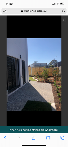

I’m looking at doing a diy and this is going to be first diy build. Plan is to build a deck out the back which already has some concrete and some dirt aswell. I’m just unsure about what to do for the structural. What do I use and how much sorry. I have attached a photo if that helps. Will be 29m2 all up

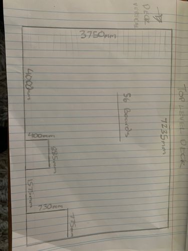

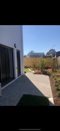

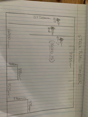

I’m looking at doing a diy and this is going to be first diy build. Plan is to build a deck out the back which already has some concrete and some dirt aswell. I’m just a bit unsure what to do for the faming on the dirt as the deck is going to go over the concrete. Planning on using angle brackets on the concrete, just don’t know what to do for the rest. The deck will go over the concrete by 1000mm. Photos
 attached

Many thanks for your question, I'd be happy to assist. There was a very similar topic to your question recently asked about a Low-level deck. The member had a concreted area and the deck was to extend out over soil. In that topic, @ProjectPete mentions that "You should have minimum 200mm but ideally 250mm clearance for H3 timber.". You will need to remove some of the soil next to the concrete to achieve that clearance.
The deck will need H4 treated pine posts concreted into the soil to support the overhanging area. Treated Pine Outdoor Timber Framing 140 x 45mm will be suitable for the bearers with appropriately spaced posts. 140 x 45mm would also be suitable for joists. You could look at dropping that to 120 x 45mm and those would need to be a special order at your local store.
