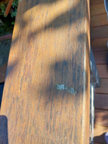

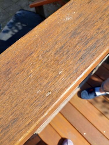

Hi @Jason / community, our deck is due for oiling (we gave it a miss last year as it was looking good) and I've noticed some peeling on the rails (I don't think it's on the ground). Do you think I need to sand the whole rail back, or can I just sand a little around the impacted areas? We use the intergrain deck oil for our merbau deck (I've posted about it before). Thanks!
Re: Deck renewal project
Hi @tremas
I suggest giving it a proper sand in order to get a uniform finish. You don't want to take a chance on your new oil peeling, it's best to give a clean surface to begin with.

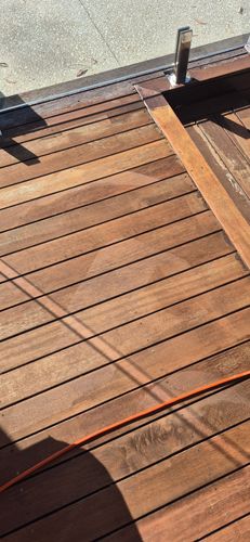

I got the floor sander and it hasnt turned out like yours ?, what am i doing wrong using a 40grit and it looks patchy ,how many times do i need to go over it
Hi @jom1,
Welcome to the Bunnings Workshop community, it is wonderful to have you with us.
The inconsistency you are experiencing is because the decking boards have cupped slightly over time, so the centres of the boards sit slightly higher than the outsides of the boards. Because of this, your initial pass with the sander has only come into contact with parts of the boards.
You're going to have to go over them again until this inconsistency is evened out. I'd give it two more passes running diagonally across the boards, then alternating direction on the second pass. Moving diagonally across the boards can help even out any height differences between the boards, which will help with consistency.
