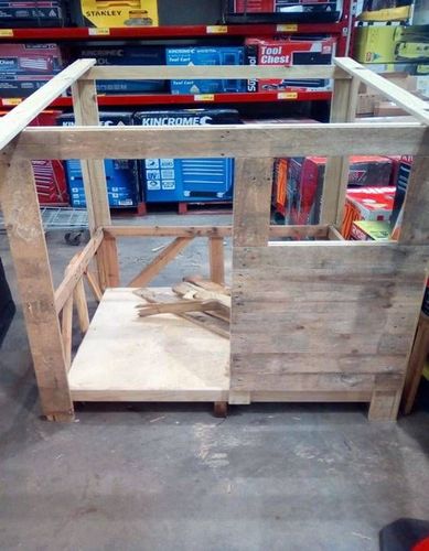

On a personal project, I started with a crate pallet for the base then built the walls and roof around it. I found it was a simple method which allowed me to use the base as a solid starting point. I would advise a similar method if you did not wish to build a standalone frame. It will save you time and the need to purchase additional timber.
Here's an example of the base and method I am referring to:
I found with my project, it was best to have an understanding of what I wanted to build, but not be constrained by that plan. When using recycled pallet timber, you may need to adapt your design or change direction depending on what size of timber you can acquire.

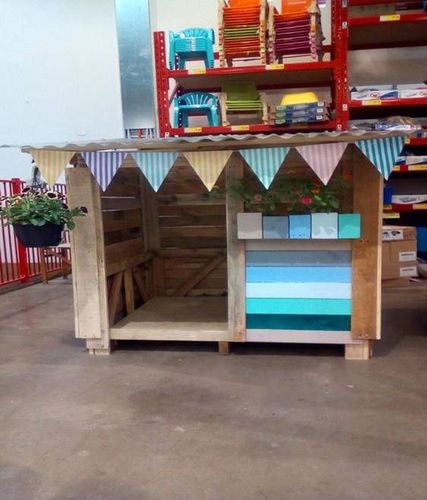

Here’s my finished project:
