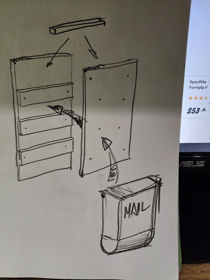

So instead am wondering about a design like pictured with 2 bits of wood on either side of the fence bolted together and then attach the letter box at the front to the wood.  I appreciate the wood would need cutting to size and then be stained or oiled to protect from the weather. But not sure if this is the  best option or exactly what I will need to buy to make this possible (and hopefully not have it look like a 10 yo's woodwork disaster). Although also happy to do something quick and easy that would be hidden behind the letter box and last long enough to perhaps do something a bit nice later on when my DIY skills have improved. I have very limited tools and no power tools so absolutely will need to borrow/buy somethings for this but not 100% sure what to get. First time home owner so suddenly have to start accumulating kit and skills to do all the maintenance around the house so ideally like things that will be useful in the future - not just for a single job now.

I think your plan is a perfect solution to the issue and it is also a great starting point for your home maintenance and D.I.Y journey. There isn't really anything I would change about your plan, so I will just help you with some guidance.
Can you let me know the thickness and height of the timber slats, as well as how far apart the holes in your mailbox are?
This will help me advise suitable materials and fixings.
You're going to need a drill with some driver bits and drill bits to put pilot holes in the timber and screw the mailbox to it. This Ryobi 40 Piece Specialty Metric Drill And Drive Set is a good starter kit. You'll also need a basic socket set or adjustable wrench to tighten the nuts and bolts. These tools have a massive variety of applications, so they'd be a great starting place when it comes to tools.
Being outdoors, you'll need to use H3 timber and either galvanised or stainless-steel hardware for their weather resistance. If you plan on painting the timber to match, then you'll need to use external paint.

"11mm thick"
I was thinking 12 mm marine ply cut to 'sandwich' between the railings.
Painted.
No Bolts.
No nuts.
No drilling.
No holes in your railings or compression damage
Just screw between the railings.
Then plenty of wood canvas to use the mailbox's original holes.
Just a thought.
Cheers.
Something like this...
