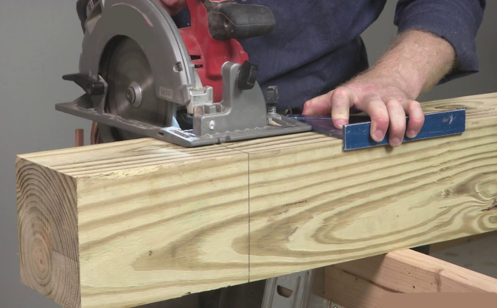

When cutting the post to length using the circular saw, a plastic rafter square will act as a very safe guide for make those cuts straight.
Any brand for about $12-$15

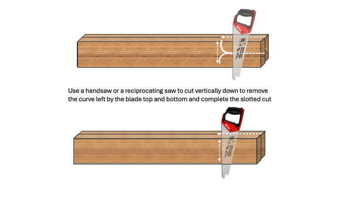

As suggested by @EricL , I would use a power saw, I would just drill a hole at the depth/end of the slot, I wouldn’t cut all the way down to the finished depth, cut to only up to 3/4 depth of the slot, then finish cutting the slot by using a hand saw, I think it would be much safer this way.

agree with Joe. These diagrams may assist in understanding
