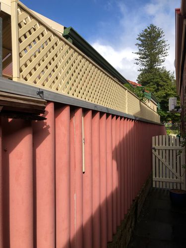

My fence extension is on top of a cement sheet fence it has a metal cap on it do I remove the cap or not ? What do you recommend .  I already have a creeper to grow into it . I'm thinking hardwood lattice but not sure how to fix it

Update: Job done, just in time for the first home open next door. My brother helped me put them up as drilling through steel and jarrah was too hard yakka for me. Learnings for next time were- put the poles up first, get a bigger step drill bit for the holes, and get the right screws (75mm timber hex screw with seal). Galvanised legs worked well and looked the part once spray painted. Thanks MitchellMc.

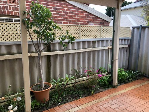

Hi! What screws did you use to screw directly into the fibre cement Hardie fence? We are seeing lots of conflicting advice online about certain drill bits and screw types. Thank you!

Thank you, we have confirmed they aren't asbestos.
We are wanting to do the same matrix fence extensions as the post above to the hardie fence. We were going to use the matrix legs as well and screw these into the hardie fence as Louise has done.

As most screws designed for use with fibre cement sheeting are designed for fixing the fibre cement to a frame rather than fixing something to the fibre cement, it is not an ideal scenario for a screw.
If there was a frame behind the sheeting that is not visible in your photo, depending on what the frame is made of, I would use either a timber or metal hex head screw in a suitable length to pass through the extension leg, through the fibre cement and embed itself into the frame sufficiently.
If there is no frame available, instead of a screw, I would use 40mm bolts with a nut and washer to spread the load. Make sure you don't over-tighten the nut, and you use a washer, or you risk cracking the fibre cement sheeting.
To drill through fibre cement, you should use a masonry bit and to drill through the metal of the extension legs, use a cobalt drill bit.
