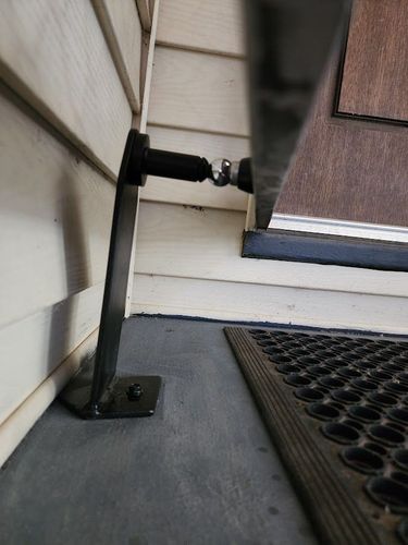

But at tools down time - 1800 hrs - I have made some progress with the OT's original idea.
Hopefully weld tomorrow.
The excessively long steel plate holding the steel ball - is just in case the magnetic 'grip' is too strong (I suspect not) and then I can move it to the left.
Trial and error.
Cheers.

Re: Magnetic Questions.
Glass of wine.
Another doodle.
And what I'm working with...
New magnet position...

"I have made some progress with the OT's original idea.
Actually, you didn't. Today has proven to be a semi-disaster or sorts.
The magnet I purchased is of 'amazing' magnetic strength. In the location I had it, seen above - you almost have to rip/distort the door to free it.
I tried the magnet at mid-door width - same problem.
One thing is certain - it will definitely overcome the tension of the pneumatic door closer - and I have the jumbo version.
Different magnet maybe?

Got there in the end.
I made quite a few mistakes and assumptions along the way that proved to be wrong.
The biggest was underestimating the 'locking' force of the magnet.
So in the end the bracket design and location changed.
Right back to the fascia with the bracket and slightly less than half the width of the door for the magnet position.
Everything nicely balanced - good adherence and a light 'tap/pull' to disengage.
Ultimately - it works well. Julie's happy and so am I.
Cheers.

Boxing Day Prototype No.2. This one must be anchored to a concrete step/surface.
See how we go after lunch.
Cheers.

When the OT suggested this I could see value.
But each time I asked him what specific items he was thinking off and could he show me examples - he just kept replying, "have a look at Bunnings."
Got there in the end with screen door No.2
