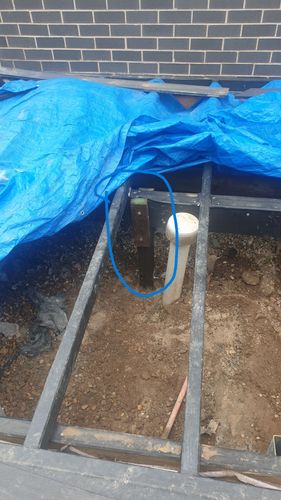

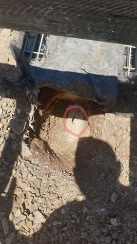

When I started digging to add the two additional posts, I found an ag line roughly 400mm from the surface where the first post should be located? What are my options here please? Will I need to reroute the agline or can I pour concrete over it ? Haven't dealt with aglines before
Also, where I dug for the second post I found that the storm water drain pipe is cracked. Is there a way to repair it please? Thanks.

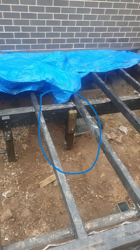

You're very close to that stormwater pit as well @tejmankar. Probably not the best idea to place a footer directly above and agline.
I'm not sure why I didn't notice this earlier but is that bearer doubled up? What's the thickness? I presumed it was a single 45mm thick bearer spanning (approx) 1.8m(?) to the post, and that's why I advised additional posts in-between. If that bearer is two laminated timbers at 90mm thick, it's should be fine as is and the deck appears to be already over-engineered. I now don't feel a post is necessary where the drain is.

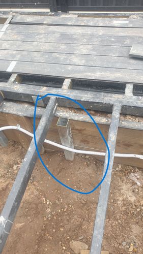

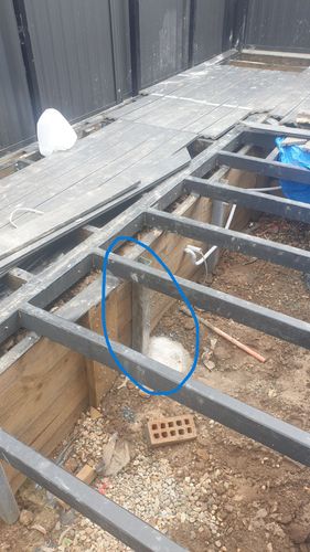

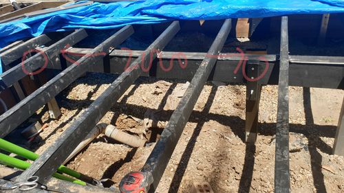

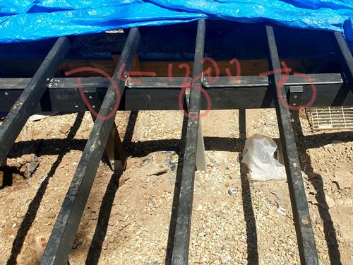

The bearer is doubled up 190 x 45 x 2. Please find photos attached with distances. I managed to dig out the ag line if a post is required and I have also dug up to repair the cracked pipe. You reckon the additional posts are not required please? Can I add the additional joists without the additional posts? Look forward to your thoughts? thanks.
Even a single 190 x 45mm would be adequate to span those distances @tejmankar. The two are more than capable. I don't believe other posts are necessary, even with the additional joists.

One more question. Since I have got all the material now and dug up everything, if I am wondering if I should just install them. I can move the ag line easily now. How far do I have to be from the storm water pit to install the post please?

Might as well install them now @tejmankar. If you can set the footer back 10cm from the pit that should be plenty.
Thanks @MitchellMc and in terms of distance from the storm water pipe, would that be 10cm as well please?

Yes, @tejmankar. Just enough gap that they wouldn't touch each other with any movement. You could likely bring the pipe right next to the foundation; I just don't want it to settle and crush the pipe on you.
