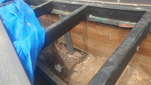

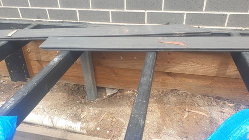

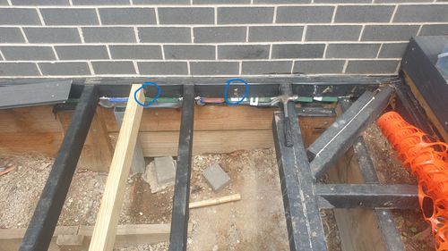

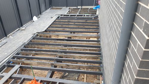

After getting the posts in, I have started install additional joists. I have noticed that the wall ledger is attached using 10mm dynabolts and is not exactly resting on the 190 x 45 H4 sleepers so I am packing the gap with packers. Also the sleepers are resting on dirt or screwed into a combination of metal and wooden posts at roughly 2m spans. Can you please kindly advise if I need to further reinforce the sleepers using 10mm/12mm dynabolts into the concrete/bricks at the back of it so they wont move if the soil sinks ? Please find some photos attached.
Looking forward to your guidance.
Thanks,
Tej
In my opinion, you've done enough already, @tejmankar. I think if you were to do any more, the deck would be capable of parking a semi-trailer on. 😃
Placing the packers between the ledger and the retaining wall will ensure any additional load is transferred directly to the ground. However, the ledger should well and truly be capable of supporting the deck by itself.

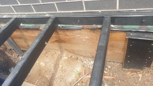

Hi @MitchellMc ,
All the joists are in. Had to shave off a fair bit to get them as levelled as I could. I will still have to use packers to get the boards levelled so there is no bounce. Manged to paint the joists with oil based paint. Please find the photo attached.
Looking great, @tejmankar. You're on the home stretch now!
What type of screws are you using for the decking boards? I've just finished using Zenith 12G x 65mm Stainless Steel Self Drilling Decking Screws on my deck, and they've saved me loads of time not having to pre-drill and countersink every hole. Well worth the extra cost.

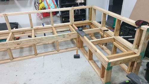

Thanks for the suggestion @MitchellMc I am using the hidden brackets between boards so the screws won't be visible. I am using the futurewood composite decking boards. They have supplied 45mm black 316 stainless steel type 17 screws along with it. In terms of packers are the window packers good enough or would you recommend the heavy duty ones please? The next step for me is to start building the bench and table frames so I can mount them on the decking frame and then find out the exact cuts I need for the composite boards. It will take me a few weeks to get these frames ready
Need to draw up the detailed plans first. Any suggestions are welcome. Thank you again.

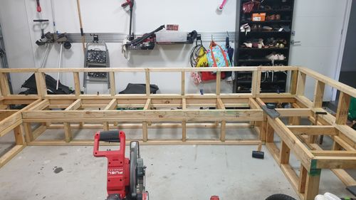

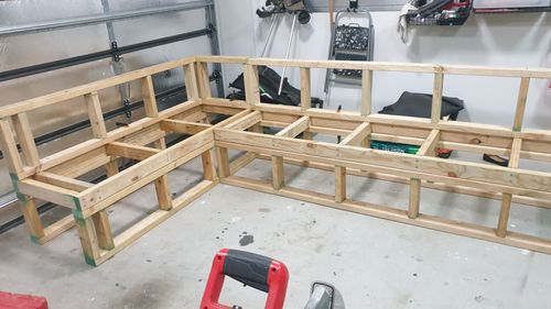

The bench frame is almost there. Trial fitting looks ok. Please see some photos attached
Hello @tejmankar
Thank you so much for the photo updates. Your bench frame looks fantastic, I'm sure it will look sensational once it's complete.
Please keep us updated with your progress, We look forward to seeing your bench seats complete and ready for use.
