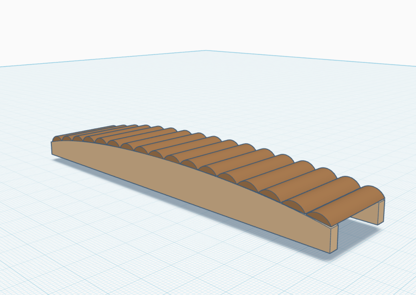

If it’s purely decorative, @annieerbs and within the pool fence, you could keep it simple by using a couple of lengths of 140 × 35 timber cut long enough to span the pond, then cutting a gentle arch into their profile. To give it that “bridge” look, you could roll some half-log edging over the top. This would create a nice visual feature without needing heavy structural work, and since it’s removable, you could take it out easily if you ever wanted to change things up.
Here's a rendering.

Thats awesome Mitchell! Definitely will make this once the pond is in! Thankyou so much!
