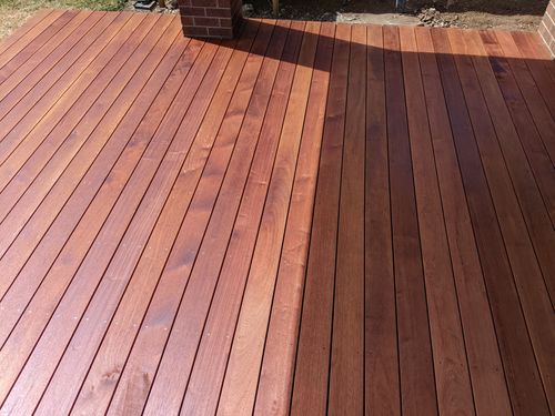

So I've been wetting the deck every couple of days and giving it a light scrub. The first time I wet the deck (without a scrub), I let the water sit and dry. The next day, I could see where all the tanins had dried up. Since I started giving it a light scrub, I've been sweeping any standing water off and when the deck dries, I see no tanin stains. Today, it's 38 degrees and I just gave the deck a water down, but didn't scrub. Now that it's dried, I don't see any signs of tanins drying. Is that an indication that weathering is working or I'm getting close to the oiling stage?
The above is the deck that's dried about 30 minutes after being wet today.

Hi @IronStan001,
If you want to skip the natural several-week weathering process, I'd recommend you scrub it down with Cabot's 2L New Timber Prep. It's designed to strip the tannins out of the Merbau and ready it for oil application.

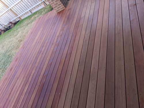

Tomorrow and Sunday is supposed to be 30, so if I prep and wash tomorrow morning, it'll have a few days to dry. But Monday and Tuesday is supposed to rain, and after that at this stage, it's dry.
I don't know what's happening, but the boards exposed to the sun appear darker than those undercover, which is why I want to get into the oiling a little sooner than the natural weathering process takes.
Actually, come to think of it, it might be those exposed areas saw a sprinkling of rain the other and it could just be residual tannins sitting on top...

Hi @IronStan001
I suspect that it might be tannins just coming out of the Merbau panels. Once you've done your wash and clean, you should notice a difference in their finish.
