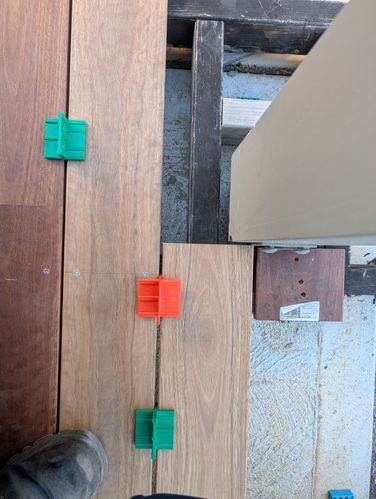

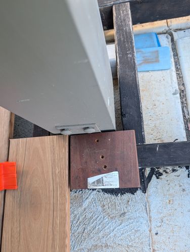

Hello @MitchellMc ,
I'm now at this part of the boarding process! lol (man, this project has been going on for a while haha)... However, I need advice on tackling it, as there might be a better way to handle it than what I'm thinking the solution is. As you can see on the pictures below, I may need to "carve" a square around the post per board. (I have long boards of 4.2m length)... on the first board that "touches" the post (post is on left of the board), I see no issue as it's just a small cut to cater with the post... on the second board, the cut will be a bit wider to "hug" the board, but I'm thinking since I have a frame there, it won't be an issue with having a thinner part of the board there... Do you think that's a good approach? is there a better way for me to handle this? Also, is it correct that I need a jigsaw for the "carving" out of the square? or I need a different tool?PXL_20251228_071059257.jpg
This one will have a smaller cut
This one will have a bigger cut...

Good Evening @yeahboo  :smile:
Sometimes projects just seem to take a little longer then what we expect, life gets in the way or we just heitate over a harder part (Thats where I am at the moment with one of my projects :smile: )
So here is my project of building an outside bench, you will see around half way down the page the same issue you are running into. Yours is easier as your posts are square to the boards :smile: The principal is the same. I would probarlly use a thicker piece of timber then I have (id use the same timber you have for under your deck, just to be consistant)
Outside bench Just ask if what I did dosnt  make sense :smile:
BTW your deck is looking good :smile:
