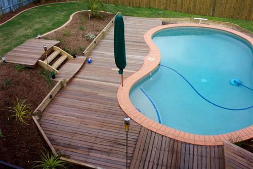

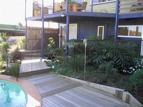

Check out the photos below of a deck I built around a pool, which might give you an idea of what your end result may look like. You can see that similar to you I had around 300mm depth. The joist were 20mm below coping height to have a continuous level in to the pool edge once the decking was installed. My jigsaw got a hell of a workout cutting each board to match the curve. It's pretty easy, just lay the board on top, trace the curve against the coping edge and make your cut. I integrated an umbrella holder with PVC pipe to have a place to soak in the pool under shade with a cold one.

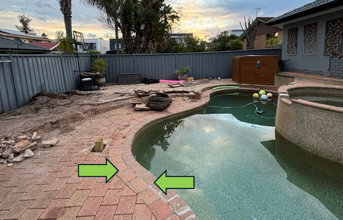

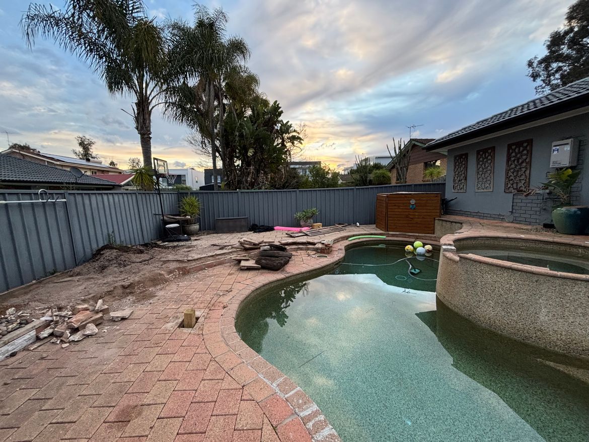

I've attached a pic below so you'll see where I am up to currently in these very early stages as well as how the edges of the pool are. I was planning on building on top of those smaller pavers so I guess we will leave them in place?
Another question, when I get to it, should I drain the pool I notice you have done?
Dave-1
Community Megastar
Re: Building a new deck where current pavers are
Afternoon @ricm
Definently DONT drain the pool. It can cause a whole bunch of issues if you dont know about.
:smile:
Hi @ricm
I would definitely keep the pavers around the pool attached and as @Dave-1 said don't empty the pool.

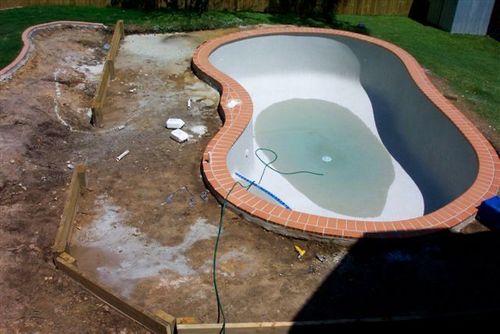

Hi @ricm your project looks very much like mine was. Answering your questions . . . .
A well built concrete pools CAN be drained without issue, this came from a mate of mine who is a pool builder. It's fibreglass ones that shouldn't as they can pop up and crack, break pipes etc. I didn't drain mine, this was a new pool. So, in your case no need to drain the pool.
If this was my project I would be leaving the last two rows of bricks at the pool edge
Tools I used were:
  • Mitre saw
  • Circular saw
  • Drill
  • Impact driver
  • Jigsaw
  • Levels
  • Tape measure
No to the tiller, but would consider a mini-loader to take away all the pavers, create some clearance for the joists above ground level (50mm) and clear the work area. Remove the last 3 rows of brick pavers by hand so not to disturb the soldier edge/coping.
Nailbag
Keep these two rowsKeep these two rows

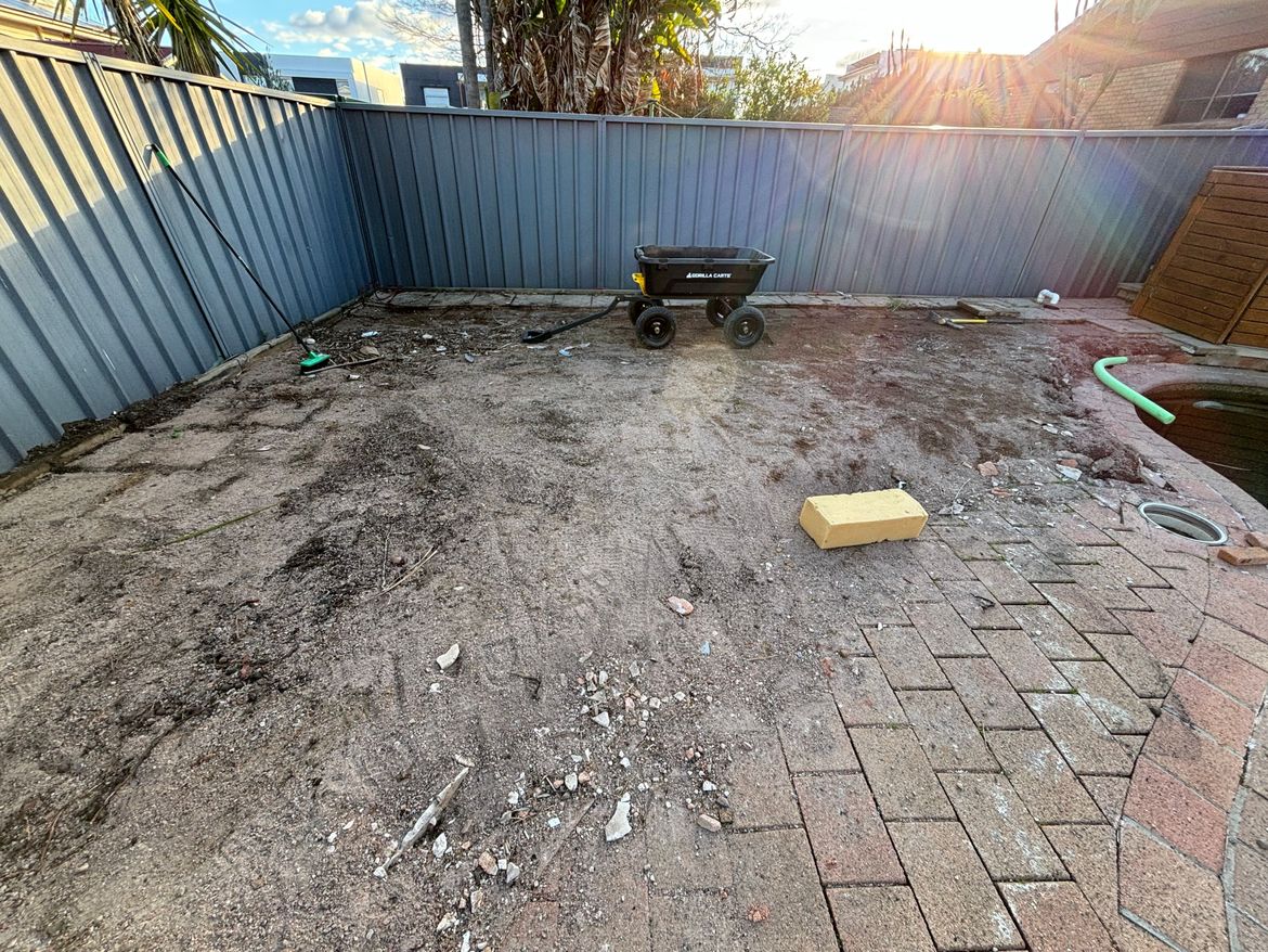

Here's the ground currently where the deck will sit-
before I start packing the ground down to get it all level, would you say if I use the Good Living Modular decking frames with adjustable heights, I don't need to level the ground (as it is going on left over pavers at each foot position)?
I'm also concerned about the edges of the pool but that's further down the track, really more about the frames that cutting the deck board to fit each part of the pool.
